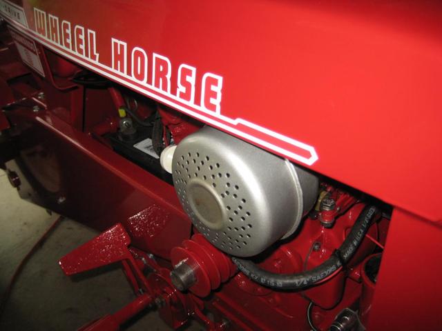

I noticed that when I purchased my Commando 8, the pipe for the muffler had been extended.
post-2221-0-79410600-1340101090_thumb.jp
The Wheel Horse parts manual calls for a 2-1/2" nipple between the engine and the muffler. I used 3" on my rebuild.
post-2221-0-50981200-1340101949_thumb.jp
I have seen pictures here on RedSquare that have the muffler as originally configured, and other with an extension.
Does anyone have any ideas on why the mufflers were extended? Is it to keep the hood from getting too hot? Pictures of tractors with the muffler installed as I did don't show any discoloration of the hood paint. :confusion-shrug:
Looks dangerously close Bob, it'll be interesting to see if the paint holds up over the weekend.

Bob, I would extend the pipe so the muffler is just outside of the hood. After all the work in painting, its cheap insurance that the heat wil not effect the paint.

Bob, I would extend the pipe so the muffler is just outside of the hood. After all the work in painting, its cheap insurance that the heat wil not effect the paint. If someone has a problem with the muffler placement, IMO ignore them, LOL!
You are probably right, but I don't think it's going to hurt that acrylic urethane, it's the vinyl decal I am most concerned about. But on the other hand, all that stuff's not cheap.

In the interest of preserving your Paint/Decal and your efforts, I would extend it so it clears the Hood irrespective of correctness.

Looks like the muffler is pretty close to the fuel line Bob, is that a problem ? :dunno:
It's just the angle that the picture was taken. There is actually between 1-1/2 to 2 inches clearance.

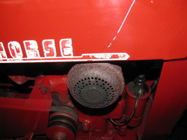

IMGP3803.jpgI also had an extension on mine when I bought it back Bob. Since I couldn't get a 2.5 inch nipple I too put a 3 inch on. I don't expect to run the engine a lot so I'm hoping there is no impact on the Valspar paint or the decal.

I think the extended exhaust is to provide a little more clearance for the mule drive on later 8hp models. you obviously don't have that issue.
my 854 had a muffler that pointed down at a 45* angle to help with clearance of the hood,etc
Seems you should have no heat related problems locating your muffler in that position.

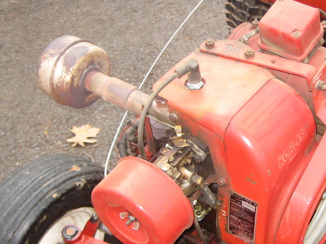

How about putting a 45 degree fitting and turn it down? I did that on my 701 and it seems to look fine.

all the early 60's kohler wheel-horse's used a 45 elbow on the muffler

yours looks correct, but i like it away from the paint, and I like the smaller tucky style muffler but they are hard to find with 1" threads that don't cost $30, I used a 45deg.fitting on my daughters 857, I think this year the pipe coming out of the engine will be changed to one that is 1" shorter, these are the best pics I could find of it.

I compromised and stuck a 4" nipple on it. Still sits partially under the hood, but the exhaust exits about 1-1/4" outside of the hood.
