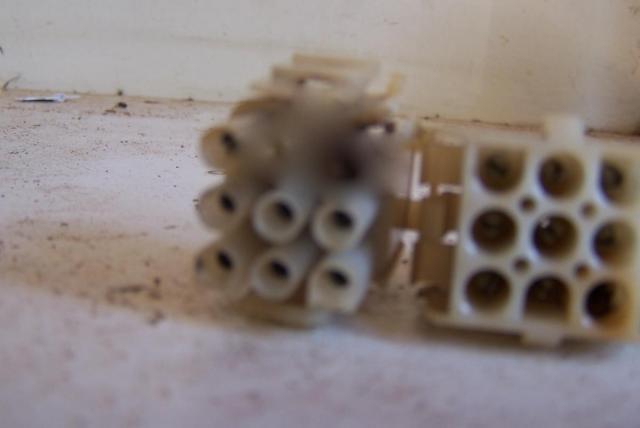

sorekiwi 761 #2 Posted June 16, 2012 First thing to look at is the 9 pin connector that plugs the engine into the chassis (in front of the battery). 1 Share this post Link to post Share on other sites

bwh3200 1 #4 Posted June 18, 2012 Jimbo, I just installed a new 9 pin connector and fuse block on my 520H and now everything works like new. I purchased the original type 9 pin connector and did not use it because of the quality. I used an automotive type connector.I did use the original type fuse block. I also purchased and installed a new ignition switch. I know for sure that the rectifier pin was bad in the 9 pin but not sure what else was bad i just know that now everything works great. By the way these parts are all inexpensive. Do you know how to use a Volt meter? I will be happy to help you out. Share this post Link to post Share on other sites

bwh3200 1 #9 Posted June 22, 2012 Unplug the headlight connector and try turning them on. If the fuse blows then its somewhere between the lamp switch and the plug. If not then its in the lights. My problem with the lights and everything else electrical was in the 9 pin connector and or the fuse block Share this post Link to post Share on other sites
jimbo7921 8 #10 Posted June 22, 2012 bwh3200 what did u use to replace the 9 pin connector? thx jim Share this post Link to post Share on other sites
bwh3200 1 #11 Posted June 23, 2012 Jim I used these connectors. The connectors are inexpensive but the crimpers are expensive. I managed to use a crimper that i had in my tool box and made them work, it was a pain. I think the proper crimper is a"F type". I used two 6 pin connectors because there were no 9 pins that i could find through Weatherpack. Good luck! http://www.amazon.com/Performance-Products-Individual-Female-Connector/dp/B0081ZY4ZS/ref=sr_1_15?ie=UTF8&qid=1340450255&sr=8-15&keywords=weatherpack+connector Share this post Link to post Share on other sites
