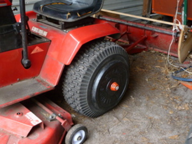

over60pirate 24 #17 Posted June 28, 2012 I did that on my 414-8 I used a 1/2" x 2" x (length that fit inside wheel) bar of steel, and welded a 1" barbell bar to it. The steel bar is bolted to 2 holes in the wheels. It's a lot easier removing weights with this setup, than oem ones. Just slide the weights on. The picture shows a 50# plate. Behind it are, smaller plates that fit inside the wheel. Total weight on each wheel is 85#'s I am also making a bar mount for the front of the tractor to hold weights, when needed. I have to mow the sides of ditches in front of my property, and the 170#'s of weight helps keeping the shiny side up! 1 Share this post Link to post Share on other sites
over60pirate 24 #18 Posted June 28, 2012 I should have added, that before I found te 50# plates, and was able to cut the bar length down, it was a real chin grabber. Especially when the weights were off. I leave the weights on all the time, for ditch cutting, and for use with the plow/bucket. Share this post Link to post Share on other sites
