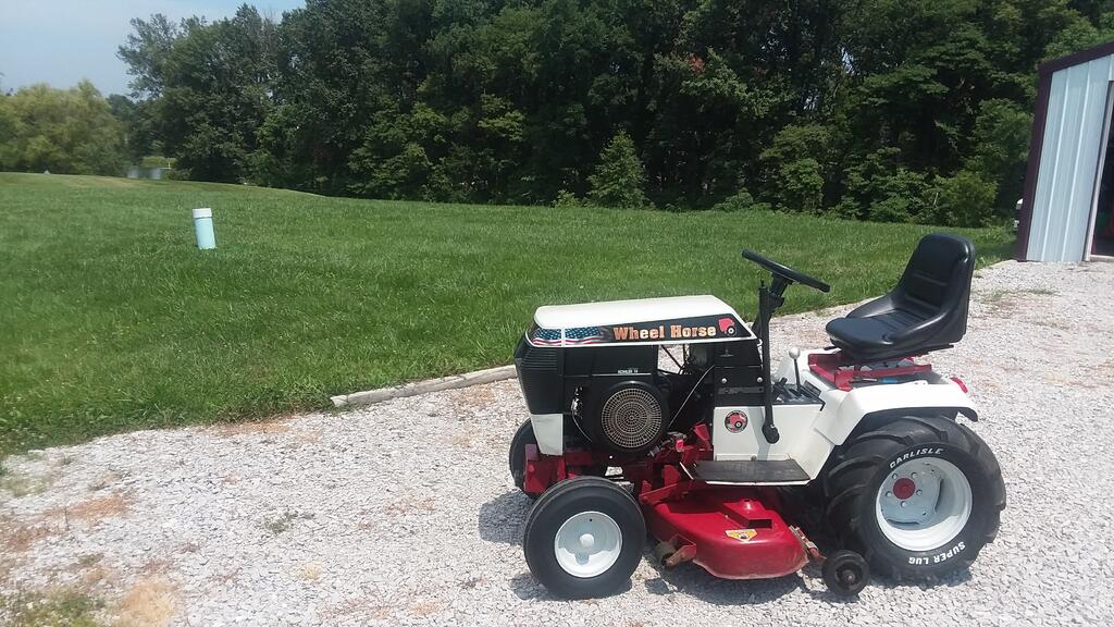

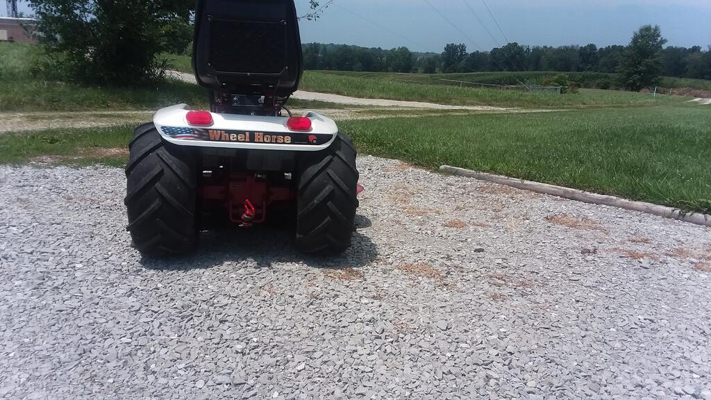

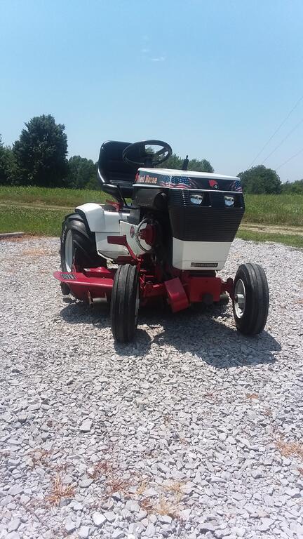

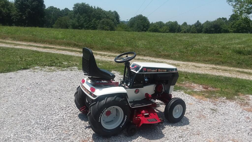

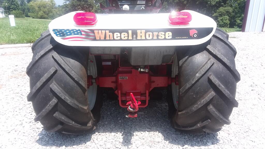

Warning:Unsupervised 83 #20 Posted July 18, 2023 Fyi- Walmart has a decent amount of tractor tires/tubes on its site & if you buy your tires off their site they mount them free. I learned Wally mounted tires free 2yrs ago after ripping a brand new front tire I just bought off there...Grrrr! It was for a JD I took for trade & gave my SIL. Heres my Deestone D401 4:00-8 tri-ribs on my 414-8. 12" tall I think? I swapped out my wide fronts to ease steering effort because I broke my neck at 21 and it still bothers me ( imagine that). It feels just like power steering now. I don't know the horse model my rims came from, bought off Ebay over a decade ago and my brain wont recall my breakfast, I got old if I remember right? But these rims have tapered wheel bearings like a trailer and are like 3.5" or 4" wide for the 4:00 tires they ran back in the day? They had brand new trailer tires mounted on them so I ran those for yrs. Always slid bad on damp grass in the turns & on hills, this tore my yard up sometimes. These Tri-ribs not only look better they are waaay better in every aspect. They never slide or tore up my yard like I thought they would. I wish I put these on from the start & tossed/sold the old trailers. These may leave a line in soft mud idk, my rear lug tires sort of hide anything the fronts ever left..lol On dry dirt neither tread heavily. The fact these Tri's grip on my hills overrides all else, absolutely love these tires! Hope this helps..... 1 Share this post Link to post Share on other sites
