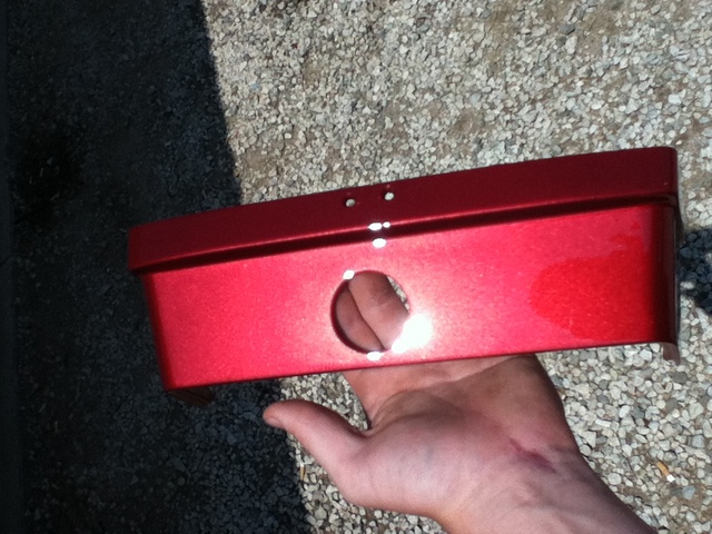

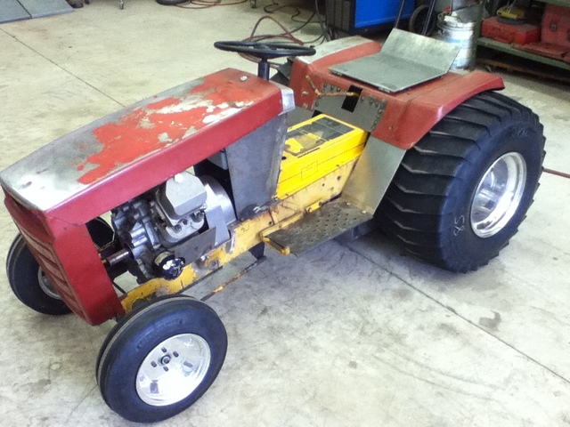

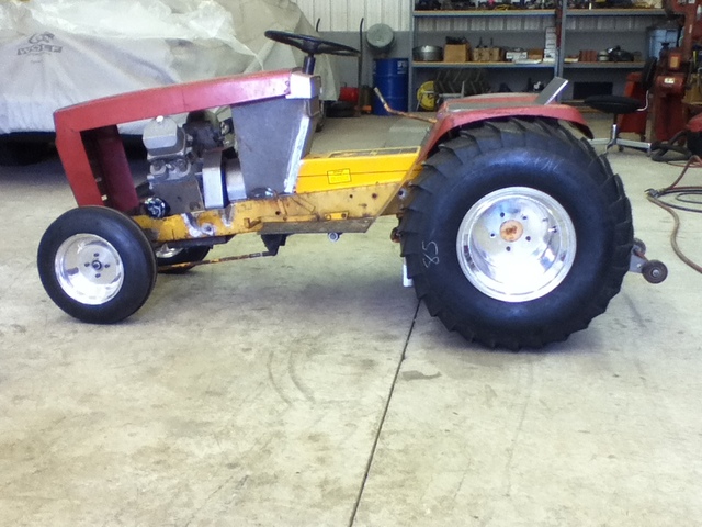

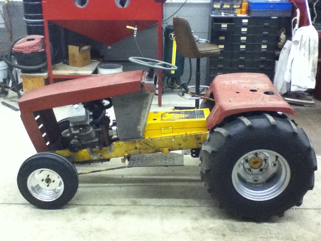

Tractor Addict 13 #1 Posted June 4, 2012 Wheel Horse hood, fenders, and whats left of the dash cowl, on a narrow cub frame with a Kohler Command. I had to make the actual dash tower. About 250 hrs of work in just the body and frame. 2 Share this post Link to post Share on other sites

1maidenfan 202 #3 Posted June 4, 2012 Cool pic's! What are you going to name it? Share this post Link to post Share on other sites
Jake Kuhn 1,579 #4 Posted June 4, 2012 That is one nice looking puller! Looking forward to maybe seeing a video of her in action sometime. Oh and :WRS: Share this post Link to post Share on other sites
Rooster 191 #5 Posted June 4, 2012 Awesome, what class do you pull in? Share this post Link to post Share on other sites
decksetter 50 #6 Posted June 4, 2012 The stance of that tractor is a thing of beauty :bow-blue: Share this post Link to post Share on other sites
Wheel Crazy 23 #7 Posted June 4, 2012 Great looking Tractor!!! Welcome to the site!! Share this post Link to post Share on other sites
Sparky-(Admin) 21,863 #8 Posted June 4, 2012 It looks great with the raked look you gave it! Mike........ Share this post Link to post Share on other sites
bowtiebutler956 650 #9 Posted June 4, 2012 :scared-eek: That thing is a beast! I agree, it has a really mean stance! It may not be a pure breed, but your definitely doing a great job representing !! Hope you'll keep us updated on the progress. Matt :flags-texas: Share this post Link to post Share on other sites

Forest Road 594 #15 Posted June 6, 2012 Wild looking ride!!!!! Are Cub rears any more durable than WH? Share this post Link to post Share on other sites
SousaKerry 502 #16 Posted June 6, 2012 Wild looking ride!!!!! Are Cub rears any more durable than WH? I have always heard that the stock cub rear end is not as durable but are upgradable with aftermarket parts, but I would not know. I think the one big advantage is the fact that they are shaft drive with a clutch plate vs a belt. Funny thing is in industry you see a lot of big machinery being driven by belts with no problem, all in how the belts are set up. Share this post Link to post Share on other sites
Tractor Addict 13 #17 Posted June 6, 2012 Cub rearends are good for up to about 18 hp then the coarse spline axles are normally the first to break. The tractor in my pictures should be close to 50 or 60 hp so i will have pretty much all aftermarket parts in the rearend. Now after MTD bought out Cub Cadet form IH in the early 80's, they changed the rearends a lot. They started to put fine spline axles and two piece carriers in them and they changed the ring and pinion to a straight tooth rather than the spiral tooth that IH used. You can put that stuff in an old style rearend but you have to change the ring gear and the axle housings and one of the axle housings have to be machined to work. Share this post Link to post Share on other sites
Wheel Horse Kid 105 #18 Posted June 6, 2012 What size tires do you have on the front and rear? Share this post Link to post Share on other sites
Tractor Addict 13 #19 Posted June 6, 2012 On the front I have 3.50x8 and 26x12x12 on the back Share this post Link to post Share on other sites

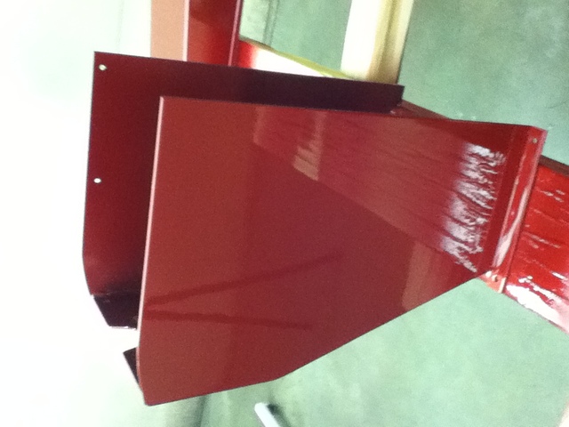

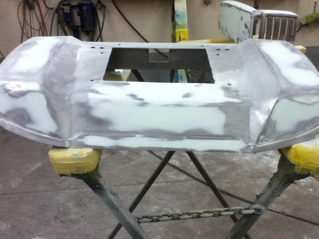

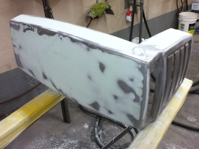

Tractor Addict 13 #20 Posted July 12, 2012 here is some pics of the pain in the ass part but its almost ready for primer and paint. Share this post Link to post Share on other sites

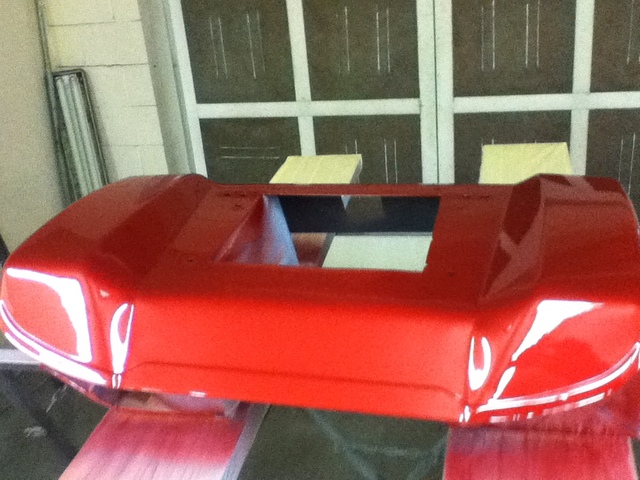

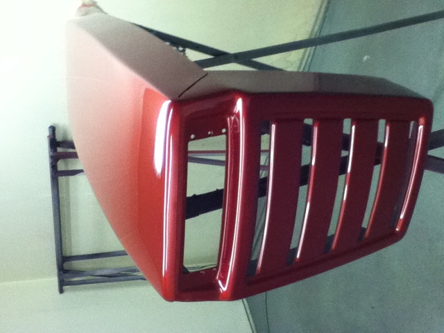

Tractor Addict 13 #21 Posted July 27, 2012 finally got it painted!! :woohoo: 3 Share this post Link to post Share on other sites
Wheelhorse84 87 #22 Posted July 27, 2012 Great color. Share this post Link to post Share on other sites
Jake Kuhn 1,579 #23 Posted July 27, 2012 It looks really good! :bow-blue: Share this post Link to post Share on other sites
COMMANDO6 20 #24 Posted July 27, 2012 cool. We're gonna have to see some pics of it in action. Share this post Link to post Share on other sites
Tractor Addict 13 #25 Posted July 27, 2012 thanx guys and dont worry ill get some pics and vids of it for ya Share this post Link to post Share on other sites
