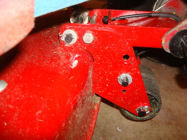

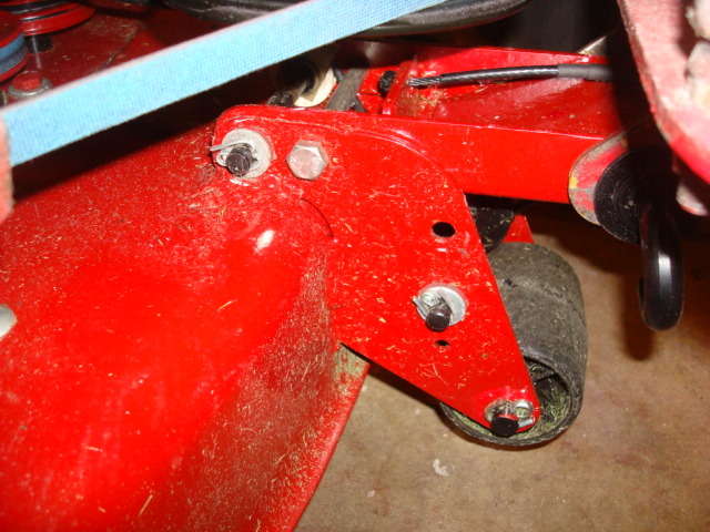

WH252-H 4 #1 Posted May 6, 2012 A few weeks back someone asked a question about how to increase the cutting hight of the WH mowing deck. I know there are several different deck designs but I recently figured mine out. I have a 1988 WH252-H with a 42" deck (model 05-42SK01). I will try to upload some pictures. The piece at the front of the mower, "front housing mount" was the answer for me. At first I could only get about 2 1/4" at most then I slide a 3/8" bolt throughthe second hole in the top of the deck bracket and the FHM (see picture). Now I can mow at max hieght of 3 1/2" and will adjust down to 2 1/2". By doing this the deck does not float as well anymore so watch those humps. I recently restored this deck and it cuts beautifully!! I will post pics in RESTORATION for S&Gs. 1 Share this post Link to post Share on other sites
