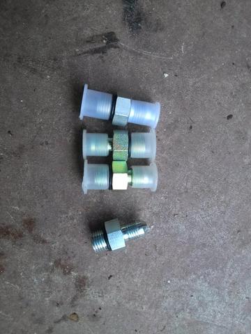

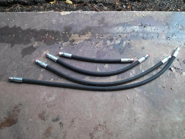

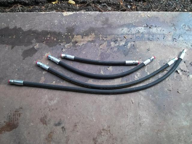

I'm cleaning up a Charger 10...making a few changes and you know how is goes....one thing leads to another and so on. I added a hydraulic lift from a Bronco to this Charger a few months ago and a couple lines leaked at the ends. I remembered a thread by CharliesD250 a year maybe more back and started checking things out. I had a hose made a little over a year ago (the shortest one) and it cost 30 bucks thereabouts. So I got pre-made hoses online with 1/4 inch JIC swivels in lengths of 12, 18, 24, and 30 inches.
post-1933-0-56732200-1336224228_thumb.jp
I also need to get some JIC to SAE #5 ORB connectors....straight ones

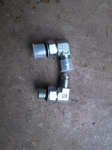

And elbows...4 of each...
post-1933-0-00473600-1336224290_thumb.jp
The elbows installed...
post-1933-0-65420500-1336224260_thumb.jp
I got the elbows locally because they were sold at a different site and with the shipping they would have cost over 5 bucks a piece. Well with gas I guess I spent that anyway, BUT, there is a 1/4 inch JIC elbow (m to f) that could be used on the same site I got the rest of the stuff. I'm going to try it next time. I need 3 hoses for the 160 and a couple for the D.

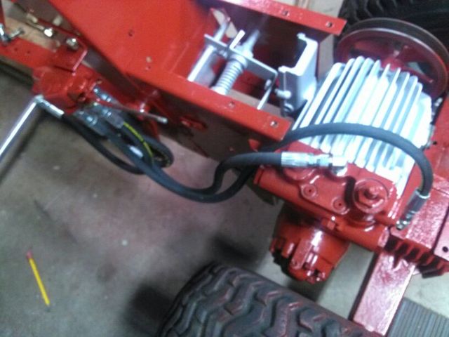

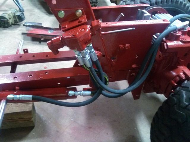

I had to see how well the new hoses hooked up and of course what they will look like.....so i did a mock up. post-1933-13364360011_thumb.jpgpost-1933-133643602703_thumb.jpgsent via mobile....
  • Like 1
dclarke
Looks good from here Bob! :thumbs: We make hoses at work, comes in pretty handy once in a while.
