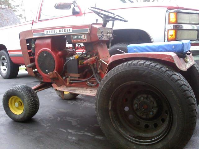

"Op"-"ole" Lol. I paid 50 bucks,didn't hear it run,it had trees growing out of the seat and enough moss for a frog to mistake it at mating season!It purrs and peels the 14" snow tires now!I always to greasy to take pics!Lol Its a Frankenstein Horse right now but I falling in love quick!Just bought a 70 Gt14 so before I get her home I have to wrap up loose ends!haha pics soon!

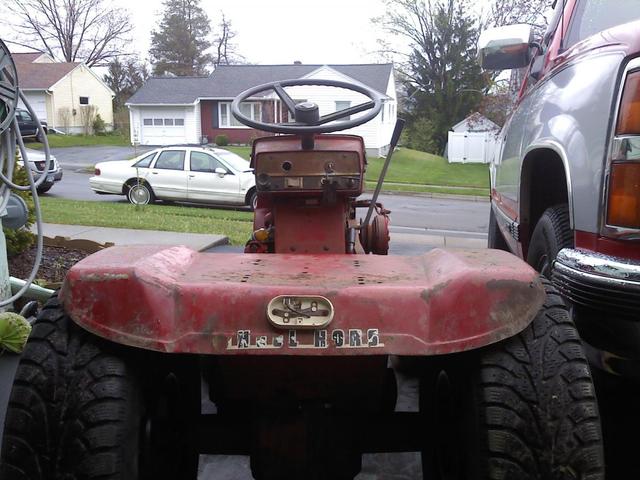

Franken- Lectro

I love it! That thing just looks mean. :text-datsphatyo::wicked:

It runs and drives soooo good now!
