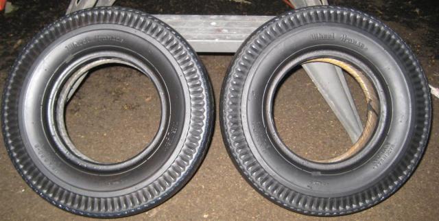

There has been some progress. Everything has been primed, and thanks to Dave (funengineer), I have front tires.

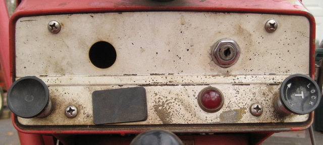

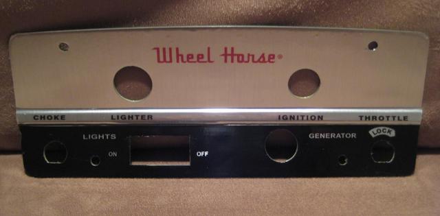

A couple of week ago, Terry (vinylguy) sent me a reworked dash decal. It has the words "LIGHTER" and "IGNITION" located in their proper spots. Tonight it is raining here in Maryland, so I decided to do a little dash reconditioning.
Here is the dash before...
post-2221-0-72673100-1338344273_thumb.jp
...and after
post-2221-0-53198700-1338343850_thumb.jp
Thanks Terry for redoing the decal.

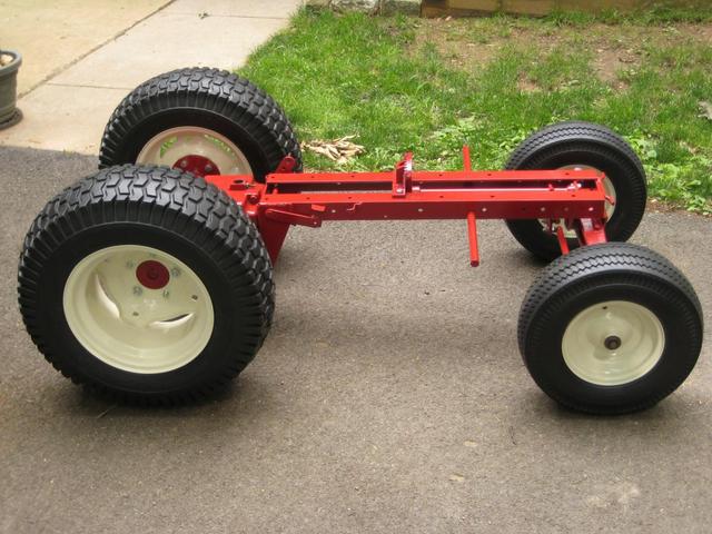

Progress report:
Got some tractor time in over the last couple of weekends. Started painting and assembling. Although a little more is done than what is pictured, here is what I have assembled as of today,
post-2221-0-12144100-1338979503_thumb.jp
The rear tires are originals. The fronts are courtesty of Dave (funengineer). The wheel are powder coated. The paint is PPG acrylic urethane in a color called GM Standard Red (WA7475).

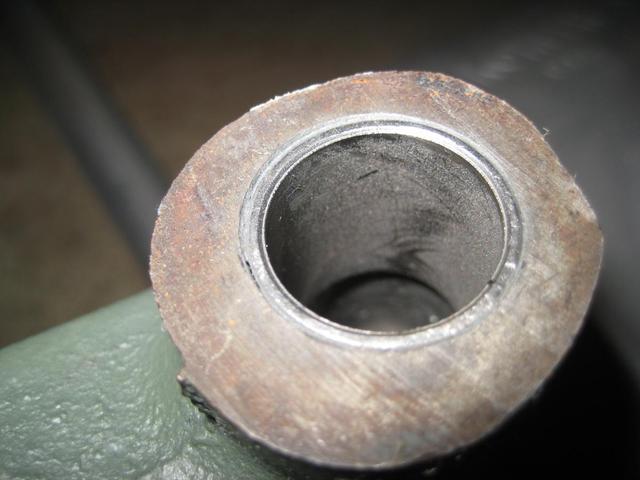

Since the axle holes were really worn, and the spindles were wobbling, I reamed out the holes and inserted bronze bushings
post-2221-0-88902500-1336762192_thumb.jp

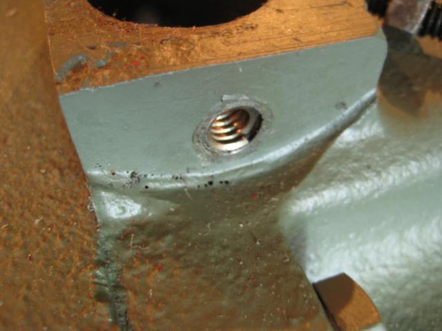

The shifter set screw hole had damaged threads, so a heli-coil was inserted.
post-2221-0-36497200-1336762187_thumb.jp

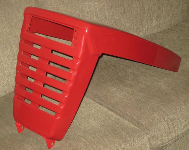

The NOS hood is sitting patiently in my basement, waiting to be united with the rest of the tractor.
post-2221-0-60849000-1336762838_thumb.jp

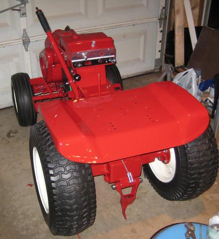

Just thought I'd update my progress. All of the painting is done, and assembly is coming along. Here is a teaser of what's been going on in the Maynard shop during the past week.
post-2221-0-82368500-1339812664_thumb.jp
Are you reusing the original choke cable Bob, looks like the throttle is new?
rmaynard
Good eye. Choke is original. Haven't had time to do anything with the knob. Throttle is new. The previous owner had a lever type as a replacement and it had to go.

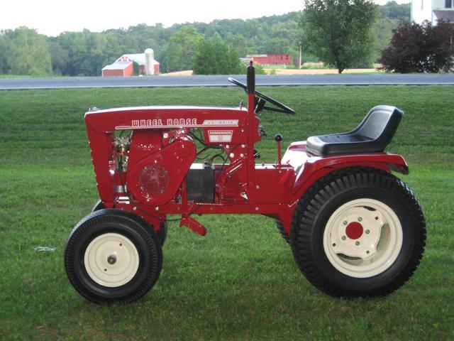

I had serious doubts that this one would get finished in time for the show. If you remember, this is what I had on April 20 when I started this thread.
post-2221-0-95793400-1339978303_thumb.jp

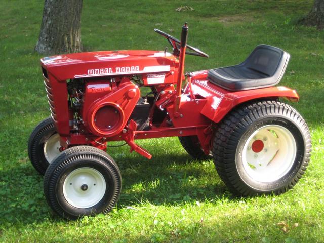

Now, here is my progress as of 8:00 PM tonight.
post-2221-0-15960800-1339978343_thumb.jp
post-2221-0-87235400-1339978646_thumb.jp
I think I'm going to make it...seriously.
