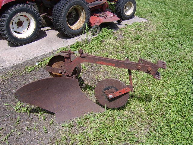

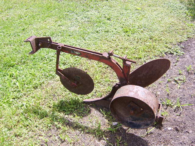

rydogg 186 #12 Posted April 8, 2012 If you are looking for a bigger plow I have this D series 12 inch for sale it's a little rusty from lack of use but once you start to use it I bet it would shine up nice. Share this post Link to post Share on other sites

leeave96 487 #15 Posted April 9, 2012 If you are having trouble with the plow sucking in, you might try adjusting the point a little at a time until it does what you want it to do. You shouldn't have to hang any extra weight on it. May just need to set it up for the machine you are using it on. +1 The plow ought to go down without weight and level out at the same depth if you got the plow point adjusted correctly. It takes some time to do this. Sometimes the coulter will hold the plow out of the ground if you have sod, and I am have taken it off for plowing, but without it, you have to use more pull to get the plow through. The 12 inch plow shown above would be a nice addition to anyone's plow collection too. BTW, when lifting the plow at the end of a row, it is a good idea to go backwards a few inches to free the plow from the soil/sod load. I broke a lift cable by not doing this and back then the cable was $26ish, now it's around 35ish - ouch! Good luck, Bill Share this post Link to post Share on other sites
