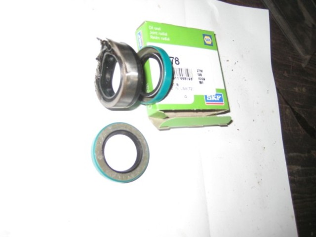

I ordered a couple 9878 1" axle seals from NAPA and picked them up today. With new seals in hand I went to install them and have run into a new situation.They wouldn't fit and thats because the HST in my 876 has 1 1/8" axles instead of 1" axles.
I searched all over it looking for an ID tag or stamping and only came up w/a tag w/90-2019 on the pump. I believe thats a Sundstrand model # and not a WH # but I could be wrong. My guess is the original owner must have swapped HST's.
Anyways, I looked up the 1276 HST model # which is 5054 and it came w/ 1 1/8" axles.The seal part number is 6449 and is still available from Toro. I crossed them to SKU seals which are # 11124 and NAPA has one in stock locally. I'll be picking it up tomorrow, I also have an 856 gear and the brake and axle seals have been seeping for yrs now so I went on ahead and ordered 3 new seals for it to. All the seals should come in by Wed.

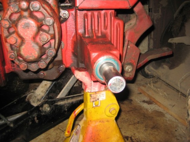

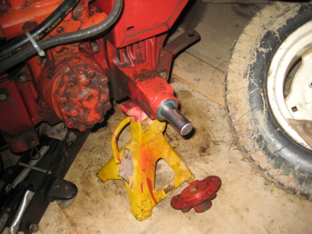

Update, I picked up an SKU 11124 seal from NAPA and this seal works!
After shineing up/deburing the axle I put a light coat of trans fluid on the axle and around the seal and popped it in. Even tho I had the tractor jacked up and at an angle (the removed wheel up higher) it still dripped out nearly a qt of fluid over night w/the old seal out.
Even tho the new seal is almost 1/2 as thick as the OEM I decided not to dirve it all the way in, instead I drove it in just beyond being flush w/the caseing. I poored in about 3/4 qt of Dexron, started it up and engaged the HST. It took a few secounds before it would spin the wheels (both jacked up off the ground) but it finally did and I took it to the extremes to try and get it bled off. It worked! :)
My dual spool hydraulic setup worked great too.
I've decided to leave the hub & wheel off overnight just to make sure it doesn't leak. so far after approx 1 hr it hasn't.
I don't know if it's a piston to piston or gear unit. How would one tell?
When I bought it I had to fix a leak behind the cam block and I also decided to change the fluid and filter. It had red automotive transmission fluid in it so thats what I put back. I used Dexron and it seems to works very well.
After looking at it again the HST is a different shade of red than the rest of the tractor so I'm convinced it was swapped out at one point. I'm actiually pretty happy that ot's got a beefier tranny in it but I don't know it's exact model number. I'm going to assume it's a 5054. in any case, I'll be measureing twice and cutting once from now on :)
1) a shot of the worng seals next to the OEM. The correct seal looked identical to these except it is 1/8" bigger. I got into too much of a hurry installing the correct seal that I didn't pause to take a pic.
2 & 3) a couple shots of the new seal installed.
