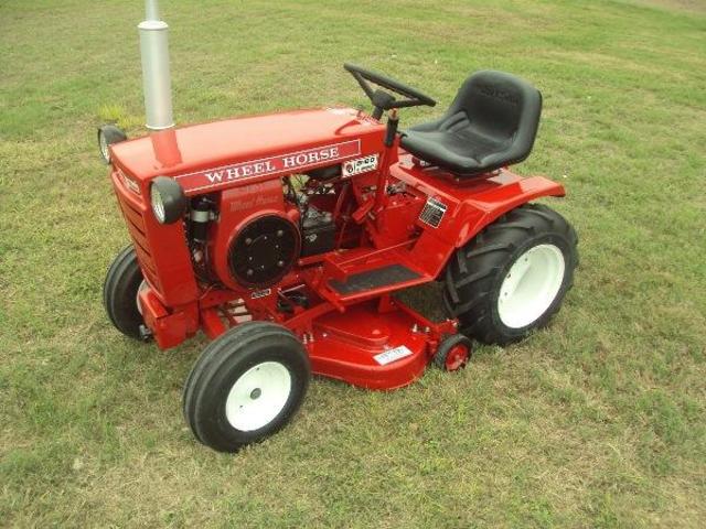

Pulled the 1067 out of the barn yesterday. Started right up and I gave her the once over for Spring. However, the front tires are going flat(original WH brand) are 16 x 5.5 x 8 and I'm having quite the challenge finding tires in this size. Anyone replace their tires with new and what was the new size or a source for this size?

I used 400x8 tri-ribs. Got them for $40 a pair on :techie-ebay: Here is a pic. :thumbs:
