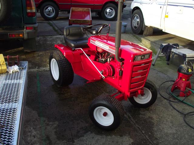

Heres a pic of my raider 10 which i brush painted. It is quite possible to brush paint to a very high standard with virtually no brush marks. Its just matter of having right technique and putting enough paint on and using a good quality brush. I have brush painted two Land rovers and a Range rover and most people cant tell any difference. Its usually crap on the brush or floating about in the air which makes it look rubbish But photos make it look even better still. Plus i can never be arsed to put another coat on. especially if the first one looks ok

Wow that paintwork looks amazing Ian did you clear coat the paintwork after you painted it? as is seems to have a mirror finsh to it
meadowfield
it's just a very high gloss finish and lots of natural light !
