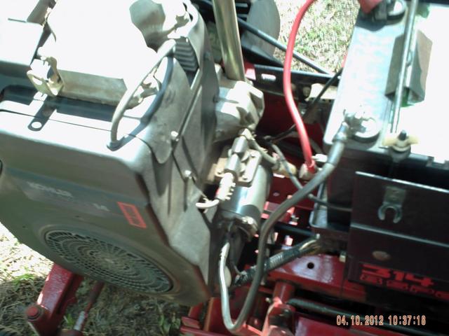

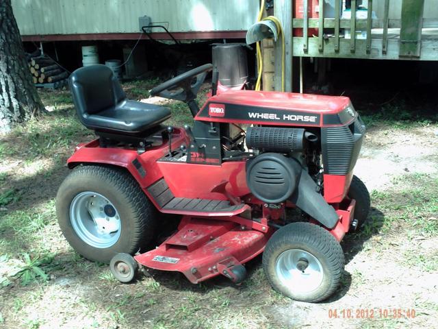

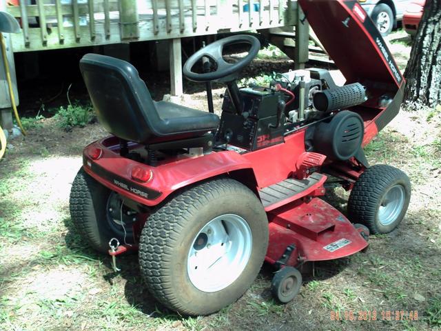

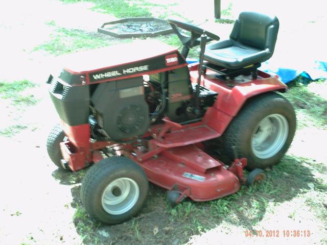

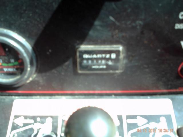

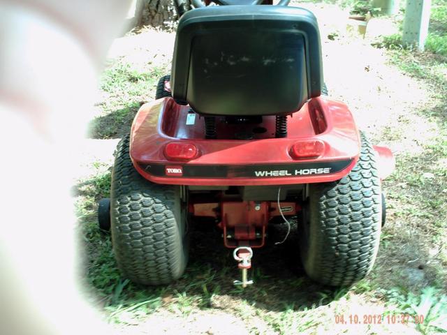

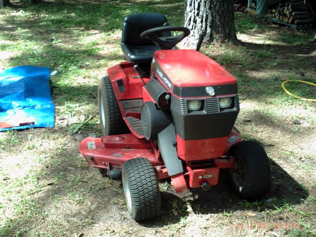

ree1man 2 #20 Posted April 10, 2012 Here are a couple Pic's, as promised, the camera is not the best, It's a little dirty right now, but not for long, will post some more soon, $300 for this, came with the 48" RD mow deck, 313 hour's on it, no smoke, start's right up, the only issue is the squeal, as mentioned above, also read in the manual word for word, "DO NOT PRESSURE WASH", the tractor, why does Toro, not want you to do that, besides the fact that you can get water in the wire harnesses, Carb,etc. Has anyone ever hurt there tractor's, pressure washing them ? A good one ... And some more ... Share this post Link to post Share on other sites

Forest Road 595 #22 Posted April 10, 2012 $300! That's a steal!the deck alone is worth $500! Take care of it and it'll go 20+ years. 1 Share this post Link to post Share on other sites
ree1man 2 #23 Posted April 10, 2012 Maybe to many Pic's ! Share this post Link to post Share on other sites
ree1man 2 #24 Posted April 10, 2012 $300! That's a steal!the deck alone is worth $500! Take care of it and it'll go 20+ years. You can count on that Forest, gonna run synthetic in it and everything, got it from my brother, who took VERY good care of it, he just is moving, and has no use for it where he is going ... :) Share this post Link to post Share on other sites
