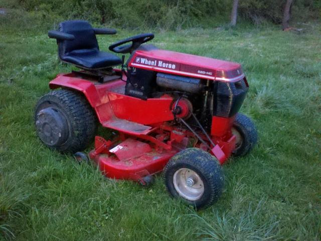

gsinal 1 #1 Posted March 30, 2012 HI all. I am a new wheel horse owner. I got last year a 1989 520-hc it came with a 42 in rear discharge deck, snow plow, 36in tiller and a moldboard plow. It ran great for me last year. I started it up this year and it started fine but after cutting some grass for 1/2 hr it started to rev up and down. It smokes a little on start up. Also i ran it out of gas before this happened and wonder if i picked up something from the tank. it did not start right away but after i ran out of gas. It has a 20 hp onan with 1200 hrs which from what i am told is not alot for an onan engine. Any ideas as to what is causing the engine to rev. I would appriciate any ideas because i am new to onan engins and unfamiler whit onans. Share this post Link to post Share on other sites

gsinal 1 #10 Posted March 31, 2012 well i went out after dinner and messed with my tractor. Put some sea foam in the tank looked at the fuel filter and need a new on there is sediment in the there. Also while getting down to the carb there looks like a crank case breather that hooks to the air filter box and goes to the motor. the r of youubber hose part that hooks to the motor is not staying on is there a clamp for that end. got it to run smooth again i worked the choke back and forth and it settled right down. here is a picture. i will put some more pics up when i get the tiller on and running my mother need her garden tilled up and it sounds like a chance to use my tractor. I want to thank all of you for answering. I read alot of posts and really enjoy all the information. 1 Share this post Link to post Share on other sites
