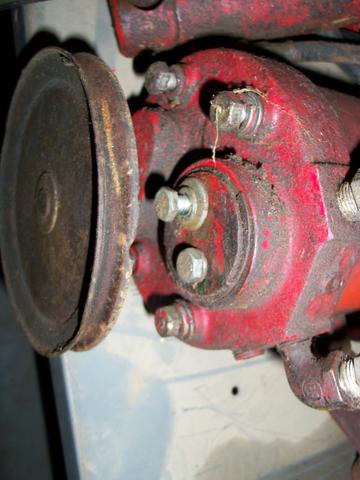

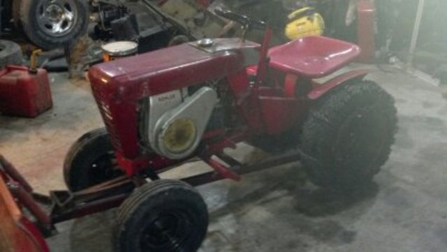

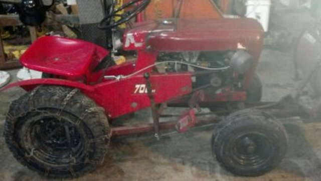

hy-2 pump mount on a 702
1054josh
i would like some help on how to mount the pump to the tower. The 702 has a manual lift thats wore out and i have the pump and cylinder but unsure about how to mount and where thanks Joshpost-6518-0-02086900-1332200613.jpgpost-6518-0-67596600-1332200652.jpg

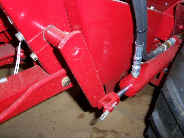

You will need the plate that bolts to the pump face, the big plate that bolts to the tower that the plate on the pump bolts to, the small pulley that goes on the end of the crank to run the pump, belt guard, bracket that bolts to the rear axle, the rock shaft that replaces the lift arm, and on a 702 they had a box to relocate the push button and key switch, I have pics of one mounted on a 63 tractor pretty much the same, but the switch box is not needed, and the rock shaft is different for the 63 up tractors, I can try to get pics of the parts you will need in the next few days, these are of my 63 machine to give you a idea.

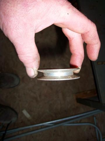

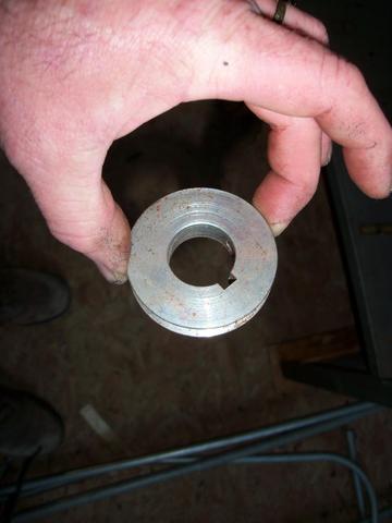

The pulley for the engine is very hard to find, it's a single sheave, and is just a little smaller in diam. than the 3 sheave engine pulley, and it is narrow for a 3/8" belt.
I'll get pics of the all the parts, in a day or so.

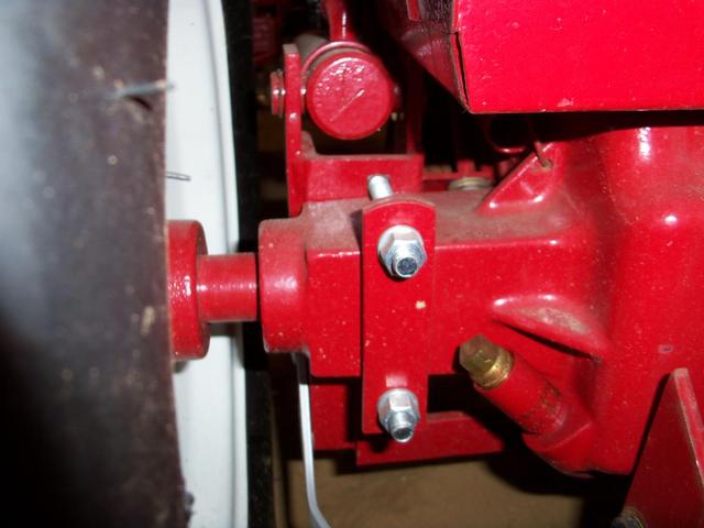

I got a few kinda better pics of the mounts on the tractor.

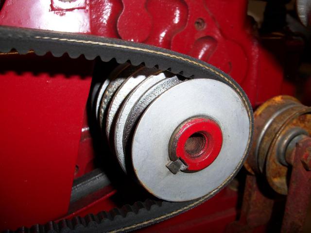

If you look close you can see the add on pulley is smaller than the drive pulley, and is for a 3/8" belt not a 1/2" like the drive pulley

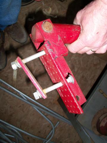

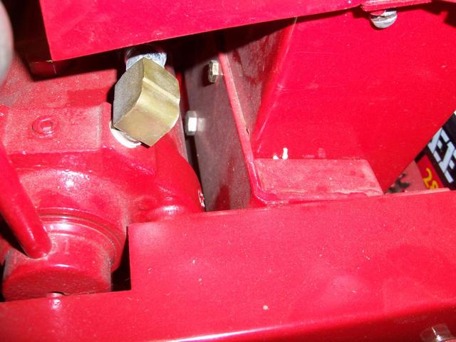

Axle bracket

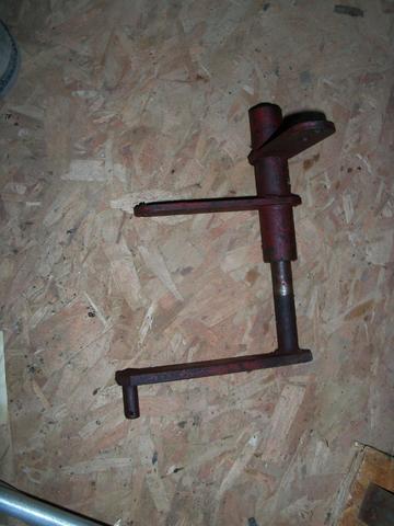

Rock shaft on my 63

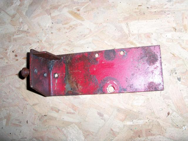

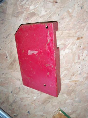

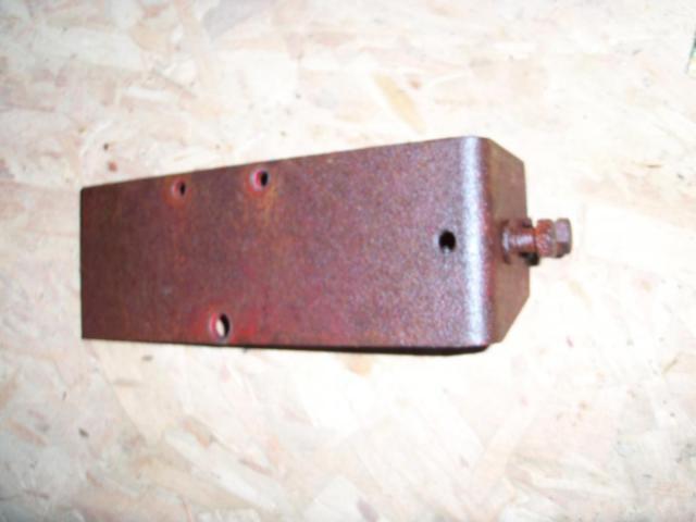

Bracket that bolts to the dash tower

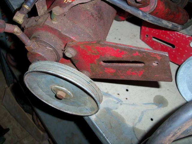

bracket that bolts to pump
Belt guard for pump pulley

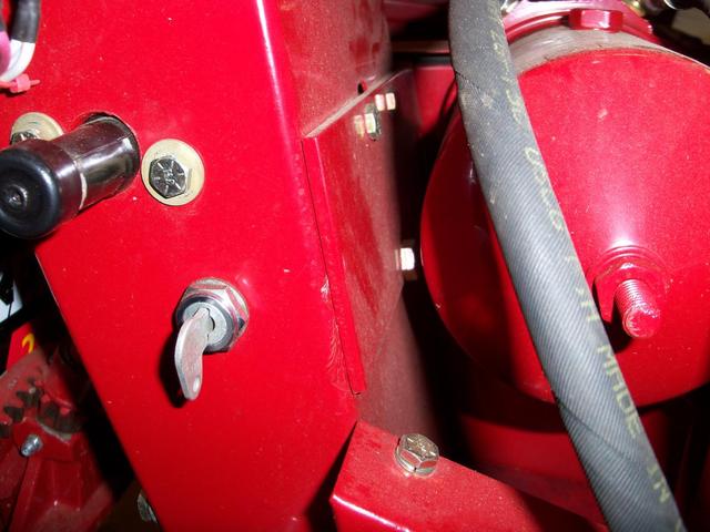

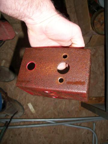

switch box needed that bolts to the left side of the dash tower to mount the push button and key switch, if you look at my post above of my 63 you can see they put holes to mount the switches in the 63 and newer tractors Picture is sideways left side of pic is bottom.
rear axle bracket to mount the lift cyl.

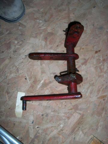

Rock shaft for the 61 and 62 tractors
Rock shaft for 63 and newer tractors
add on pulley needed to run the pump, takes a 3/8" belt

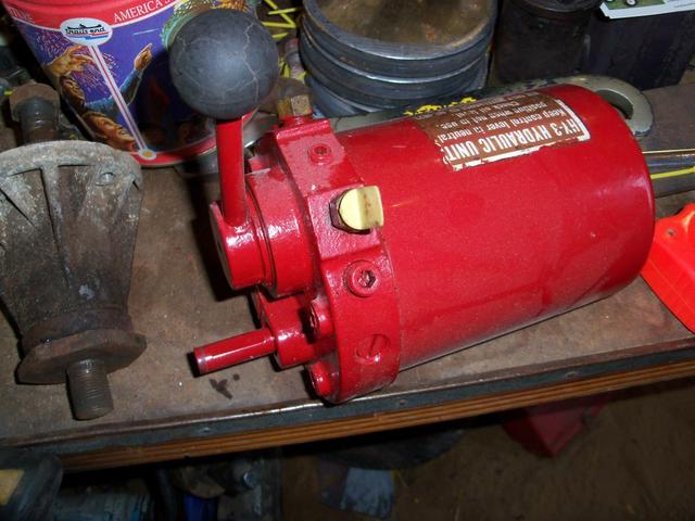

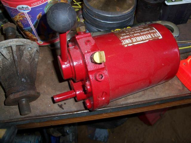

There externally is two pumps, the first is for the add on HY kits, note how the valve sticks out and the handle screws in to it.
This pump is from a 953 or 1054, note how the valve is flush with the pump face, the handle is made of flat stock and bolts on withe two screws, no handle on this pump.
Both pumps will work, but to be correct you need the round screw in handle, also be sure the return spring is good, you should be able to pull the handle foward or back and it will self center, if not it will have to come apart and a spring put in it, there is two style springs, you have to open it to be sure what one you have.

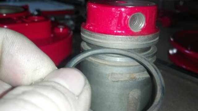

lift cyl. ready to assemble

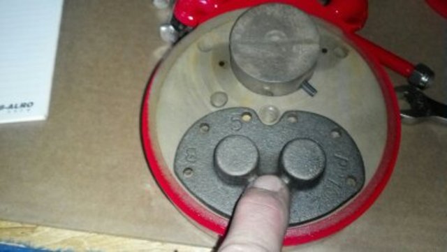

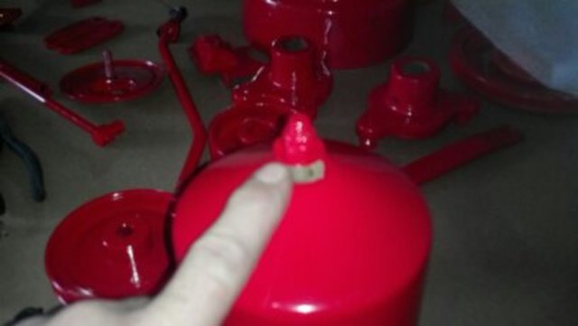

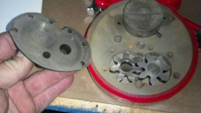

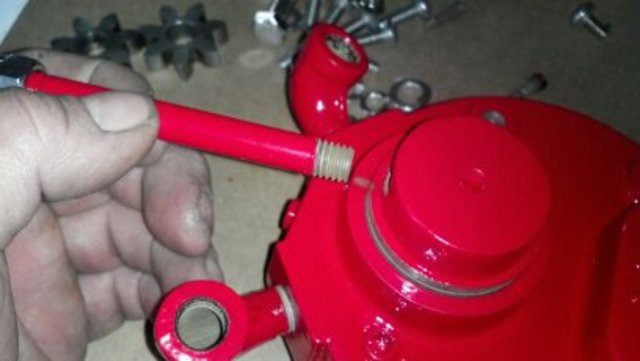

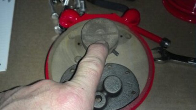

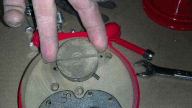

This is the center bolt that i took out to get pump reservoir off
this is were the spring is supposed to mount to the control lever
this is were the spring mounts to pump housing to return the control lever to centerpost-6518-0-98705500-1332896680.jpg
once this rod is unscrewed u can remove the snap ring clip
then the control is pushed out and the only seal on it is a o-ringpost-6518-0-85490900-1332896678.jpgpost-6518-0-92774400-1332896679.jpg

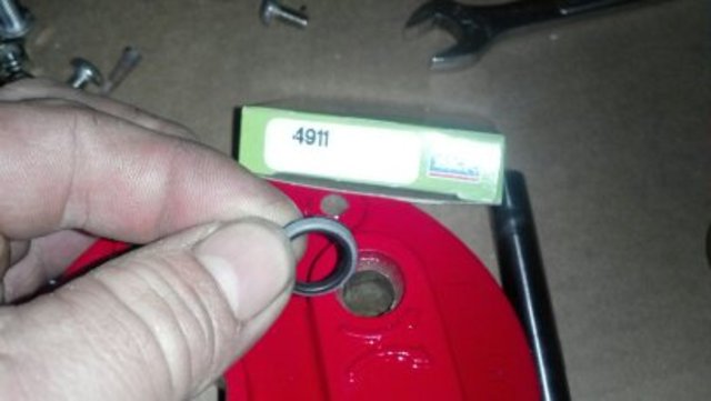

gears under the coverpost-6518-0-58267300-1332896682.jpgand the new pump shaft seal from napa thats behind the drive pulley
