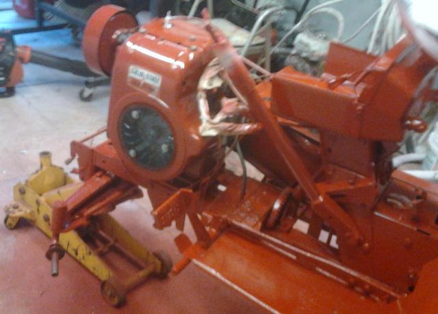

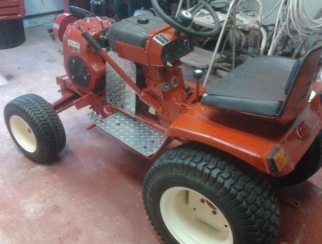

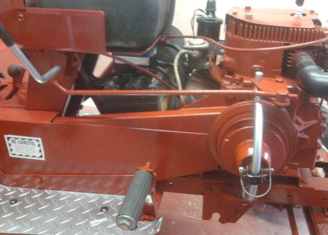

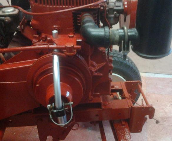

hym123 14 #1 Posted March 12, 2012 Well started with a carb and no power problem than had no spark i have had this C120 for twelve years when i bought it it was in great shape Town of portland Ct owened it for draging a chain link fence around the infield of the baseball field but since i have joined red square and was asking questions aboutmy other problems decided to re do tractor coming to gether slowly here are so pics if anyone knows what color silver they used for the pto handle and the belt retainer on the pto just got to order few things like decals, shifter boot and new seat cusions 1 Share this post Link to post Share on other sites

rmaynard 15,794 #3 Posted March 12, 2012 I painted my B-100 PTO stuff with Super Silver from Michaels Crafts. The next one is going to be powder coated White Aluminum, (RAL 9006). Share this post Link to post Share on other sites
Jake Kuhn 1,570 #4 Posted March 12, 2012 Looks really good! Jake Share this post Link to post Share on other sites

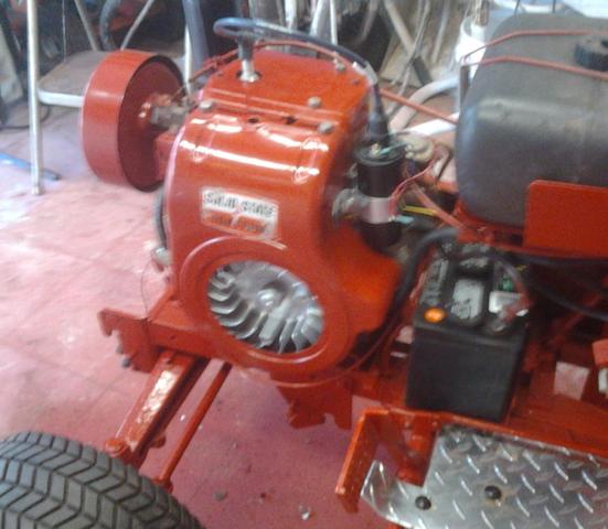

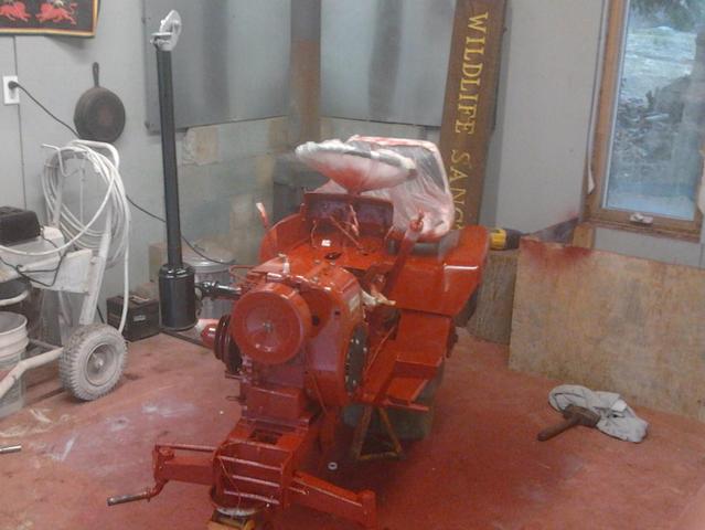

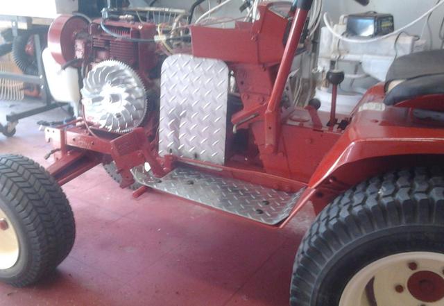

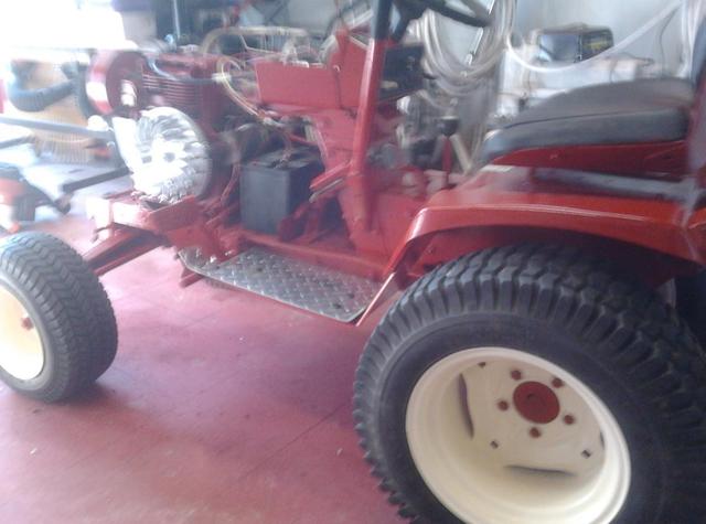

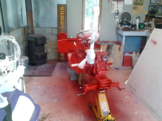

hym123 14 #5 Posted March 13, 2012 Well tractor slowly coming together worked on outing parts on motor,axle seals ,rewiring. Sprayed more clear on the Hood here are some more pics Share this post Link to post Share on other sites
Trouty56 567 #6 Posted March 14, 2012 Wow...don't park that thing in the snow...you'll never find it....hehe...just kidding......you forgot to attach the pics. Well for me the background is white...never mind...... Share this post Link to post Share on other sites
Wheel-N-It 2,969 #8 Posted March 14, 2012 Looking good! Share this post Link to post Share on other sites
hym123 14 #9 Posted March 14, 2012 Ok here are some pics had to crop photos to be able to upload my bad Share this post Link to post Share on other sites

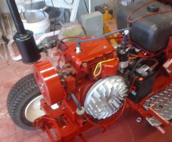

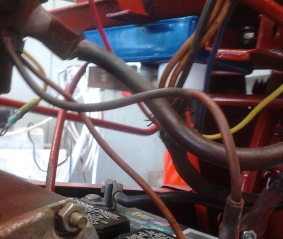

hym123 14 #10 Posted March 18, 2012 Ok here are some up dated pics of project just hooking up the ed stober ingnition system checking to make sure it all works having hard time with trigger sending spark to spark plug when flywheel pins pass by trigger other than that putting all parts back on and wheels and such starting to look like something more pics Share this post Link to post Share on other sites
hym123 14 #12 Posted March 18, 2012 more pics haveing hard time posting them all together pain in the u no what Share this post Link to post Share on other sites
hym123 14 #13 Posted March 22, 2012 K got the tractor running finaly had to put the Ed stober electrical unit in because you can't get tekky ssi units any more it an electical control module for a chrysler it works mint thanks to the help of Chuck from Save old iron he was a big help now have to tidey up the wiring and but the hood on and the tractor restoration will be complete will post pics in a day or two if anyone has this problem i have some topics from chuck and the Ed stober site engines and magnits .com Share this post Link to post Share on other sites

Save Old Iron 1,568 #17 Posted March 22, 2012 Eric, great news about the ignition mod - glad it all worked out and thanks for your patience in working out the bugs in the SSI module. I did complete some prototype pickup coils last night. If you ever feel you want to investigate one, I'll be happy to send one out to you. These prototypes have a rare earth magnet instead of the older 1970's nickel based magnets. The pickup can be placed further away from the flywheel pins and allows for a more forgiving setting of the pickup coil. Other than gap setting, the function is the same. Tell your dad thanks for the assist with the o'scope readings too. Share this post Link to post Share on other sites

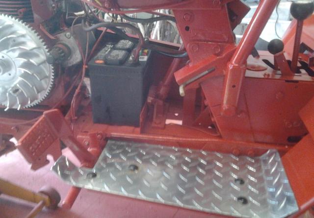

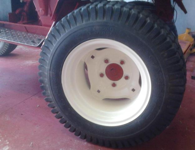

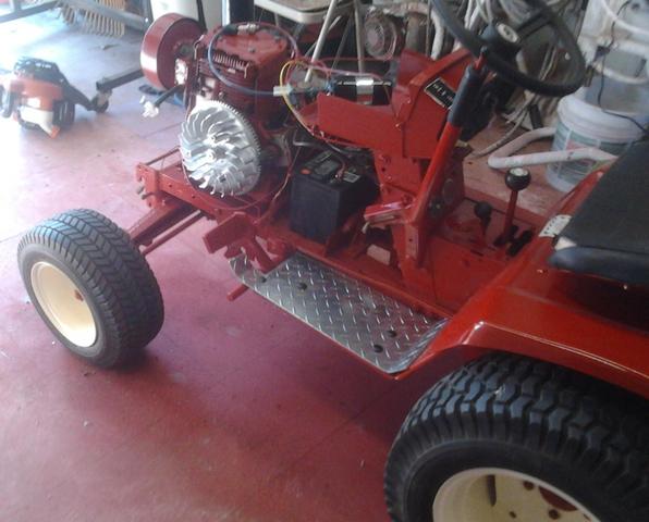

hym123 14 #18 Posted March 26, 2012 Finished my C120 short of finding a new original seat and decals finished odds and ends cleaned up wiring from the wells ignition and mounting the coil set the timming carb is all re built had to set governer tweek with carb and trottle cable this is always a little tough to get just right the carb is hunting just at mid throttle and some times when i accelerate or decelerate throttle fast than catches up and stops hunting sprayed carb cleaner on throttle sure enough hunts when i sprayed it, pain in the #!#!#! It doesn't hunt at low idle or at full throttle any body have any thoughts? gas cap is good all new gaskets too could the spring on governer be eather to tight or to loose due to were i have boaden cable adjusted i have tweeked the hole set up about ten times wish i had a tach to check rpms at idle and full, any way sounds great and with the new ignition now finally have great power again here are some pics More pics pics pics Share this post Link to post Share on other sites
