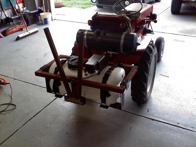

Iggy68 28 #7 Posted March 10, 2012 Here is the one I built for the back of the 953. The picture is before I had it plumbed and the nozzles on the arms. 1 Share this post Link to post Share on other sites
