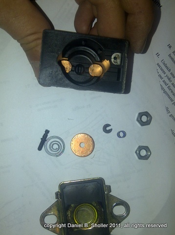

Save Old Iron 1,573 #15 Posted March 6, 2012 After reading your post on how you got this far, I think you are underestimating your potential to learn, adapt and overcome. Replacing the relay is the easy part - learning about why it failed is the FUN part. The relay pictured above was brought back to life by turning the copper disk over to the opposite side and rotating each of the damaged copper studs 180 degrees to allow exposure of the disc to new material on the studs. FYI - don't assume the relay is not being triggered because it is defective. Many times, the ground side of the relay is not secured to a clean, grounded chassis connection. This can make the relay look defective when it is not. Run a jumper wire from solenoid ground (the metal on the relay case) to a good chassis ground and try again to engage it off the relay trigger terminal. Will SOI's red-caped cabana boy convince DSHOLLER to take apart the relay ? Stay tuned..... Share this post Link to post Share on other sites

dsholler 54 #17 Posted March 6, 2012 SOI will probably convince me to take it apart, the question is whether he also convinces me to put it back in the tractor after I have messed around with it I will run your test with the ground (I did test the integrity of the wiring to the battery, and that was good). What I do not get is how that could happen. The solenoid has a metal frame outside the plastic case which I presume is the ground. this is bolted to another plate that is bolted to the frame.. It would seem impossible that there is no contact between the solenoid frame and the tractor frame, given that there is probably 3 square inches of surface area in contact with the frame. Share this post Link to post Share on other sites

dsholler 54 #19 Posted March 6, 2012 OK, So SOI set me a challenge, and I had to take it up. I tested the ground circuit, and I had continuity from the bolt on the solenoid to the frame. I tried jumping it as well, and no luck.. so the solenoid is the culprit. I took it off (How to get it back on is a different story. It was pretty hard for me to reach up behind the panel and over the steering quadrant to reach the nuts..I am not quite sure if I will be able to get it back on without taking the whole panel apart, which has its own issues)I bench tested it as SOI described in another post in this forum, using the battery instead of a battery charger (Because mine is one with a polarity safety switch, and will not deliver current if there is no existing voltage ) In any event, the solenoid worked intermittently, sometimes showing zero resistance and sometimes wandering all over the place. the word "cooked" seemed to keep popping into my mind.. In any event, I decided to take it apart and have a look. this is what I found (minus the electromagnet module).. (having trouble including pictures and text, see the post below) I don;t know if it shows in the picture, but the disc and the bottom of the poles were quite pitted. The problem is that this thing was clearly not designed to be fixed. The ground wire is a tiny gauge wire on the bottom of the electromagnet, and of course I broke it when I took it apart. I suppose I could re-solder it, but I am no great hand with a soldering iron. Also, the poles are not symmetrical, which means I cannot just turn them around and use the other side. Also, the disc is held on to its spindle with a tiny plastic locking ring, which I removed, but I am very suspicious of its ability to be replaced without deforming it.. finally, the whole thing is just pressed together, and I am suspicious of whether I can get it back as sturdy as I took it out. Maybe I was just too clumsy when I took it apart, but I think at this point, even if I can reverse the disc and get it to work, the pitted poles will still be there.. and for the price of a new solenoid it would make sense to replace instead of repair. Share this post Link to post Share on other sites
Save Old Iron 1,573 #21 Posted March 6, 2012 Daniel, thanks for the update and the pics. I don't think the images I posted earlier showed this clearly enough, but the top starter studs on the one I autopsied were really "blown away" by long term usage. Pressing the studs out of the case - rotating them 180 degrees gave them a new life. For my next door neighbor on a fixed income and gas at $4.13 / gallon, we saved him $25 on a saturday afternoon so it was worth it. In your case, the difficult physical location of the relay warrants a new (and high quality) replacement. hang onto the electromagnetic - next time you are out shopping, grab a box of paper clips and let the kids learn a few things about electromagnets - maybe even a good school science project ! Share this post Link to post Share on other sites
dsholler 54 #22 Posted March 6, 2012 yeah, those are really fried. Mine does not look that bad, but as I said, they are not symmetrical, so they only fit into the case one way, so I cannot rotate them as you suggest (Hey, I would have tried it.. I am enough of a cheapskate to want to save $25.. but at the same time, I only have a limited amount of time to work on this thing.. and the lawn is already showing signs of life here in CT.. a month early, so I need to get crackin'... Thanks for your help though. I will let you know whether the new one fixes things.. Dan Share this post Link to post Share on other sites
