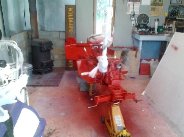

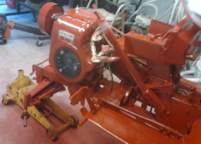

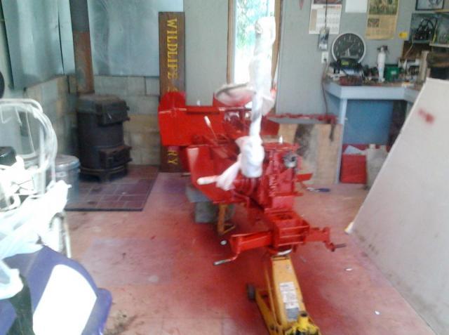

Ok got my ignition parts from napa going to dry fit all components cut wires ,conectors and such my father disected the trigger coil found the wires in the back like ed's site sayed to do my unit has no electronic board mine is the older ssi rats nest wiring, unit very hard to find the right wires and they are very very small thanks to my father the electronic engineer found them in the hardened backing, tested the unit and works now just have to put control module and coil some were, hope it works ,re did complete tractor got a litle carried away but it will be nice when done, if it dosen't work i do have a fourteen kohler in stead of the tekky here are some pics
