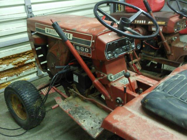

HorseWhisperer 243 #1 Posted February 24, 2012 Ad said been sitting in the barn,needs attention.A hundred dollars and a charged battery and I have a running Briggs.Tires had air and it fired right up.Didn't realize all Commandos weren't short chassis.Now I have to hunt for a new plow.Does anyone know how the plow frame hooks up in back? Its a bit different than I'm used to. Share this post Link to post Share on other sites

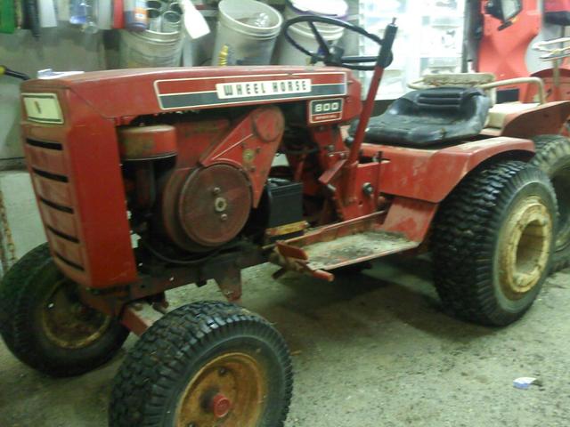

HorseWhisperer 243 #2 Posted February 24, 2012 71 800 Special with a Briggs. Share this post Link to post Share on other sites
Kelly 1,030 #4 Posted February 24, 2012 The plow bracket is built in to the frame, all you need to do is add the latches, if you look at it you will see what I'm talking about, and the plow rear cross bar will have to be made longer it will hook up on the outside of the plow frame not the inside like on a normal long frame plow. 1 Share this post Link to post Share on other sites
HorseWhisperer 243 #5 Posted February 24, 2012 Thanks Kelly,the hooks or latches are "special" to these?I saw the two slots and a small square hole above each. Share this post Link to post Share on other sites

Keith 21 #8 Posted February 24, 2012 71 800 Special with a Briggs. I also have an 800 Special. Do you know what model B&S motor your's has ? I found a model # 190434-0638 but the OEM motor did not have recoil start. The original motor looked like the one that you have. Share this post Link to post Share on other sites

Kelly 1,030 #10 Posted February 24, 2012 When I had my 800, I used latches off a reg. plow bracket, they bolted right on. 1 Share this post Link to post Share on other sites

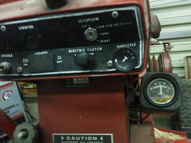

HorseWhisperer 243 #14 Posted February 24, 2012 KEITH-I will get back here tonight with the #'s.This is all stock with a starter/generator and it appears to even have an add on voltage meter.looks dealer added. Share this post Link to post Share on other sites
HorseWhisperer 243 #15 Posted February 24, 2012 Keith,the engine numbers are....190434 0638-01 7009291 Share this post Link to post Share on other sites

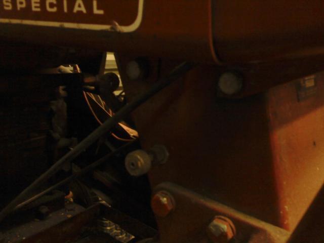

HorseWhisperer 243 #16 Posted February 25, 2012 I have since found a petcock mounted under the dash/left side.It also has a clean mounted volt meter under dash on right side?Kinda thinking dealer? This is the petcock Share this post Link to post Share on other sites
