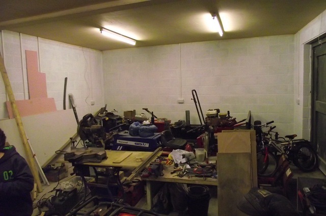

Raider10 3 #6 Posted February 11, 2012 Think the new workshop is more than broken in! Surprised he can do anything in there. Looks worse than mine already. Hardly any floor space left! Think He used his snow plough to push everything through the doors and then shut them quick before it all falls out Heres a pic if you don't believe me! Share this post Link to post Share on other sites
