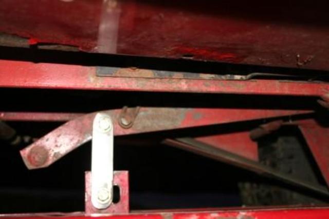

kruzr 1 #1 Posted February 5, 2012 Well I got my new (to me) 416-8 into the shop today and gave it a good once over. So far here is the punch list of what I have done and need to do. NEED TO DO 1. Needs a new battery (previous owner said it was new but its not) 2. Tune up needed. Runs good but want to start fresh. Plugs, oil, air filter, gearbox flush and fill etc. 3. Needs new key switch. 4. Needs seat replaced (old and cracked) 5. Need headlight bezel welded due to a crack near the headlight clamp. DONE 1. Adjusted rear brake 2. Removed all the jurry-rigged screws and wire holding everything together. Installed new pins with clevis pins where they should be. 3. Made (1/4" stainless) and installed new plow lift connector plate to replace the POS tin plate that was being used. 4. Removed hood and made a new stainless hinge pin. Also welded in some bushings to the iner side of the hood brackets to reduce wear. 5. Adjusted all linkage for the plow assembly. Greased pivot points. Now the plow works GREAT!. 5. Greased all jerks. Pushed out all old grease with nice new stuff! I need to take some pics. so that I have good before / after history. ........stay tuned for additional updates. Share this post Link to post Share on other sites

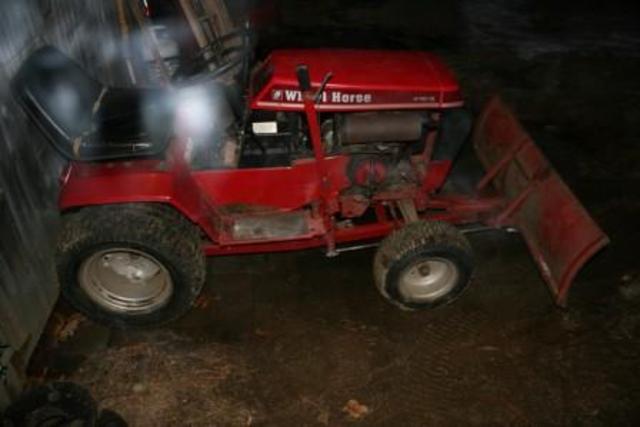

kruzr 1 #7 Posted February 5, 2012 Pictures as requested 1 Share this post Link to post Share on other sites
1maidenfan 202 #8 Posted February 5, 2012 :text-worthless: Beat me to it, Nice tractor Share this post Link to post Share on other sites

RedMaine 1 #10 Posted February 6, 2012 Beat me to it as well.. I was the one that was there when you were picking it up! needs new front tires (severely cracked) but not a big deal.. Good luck with it! Share this post Link to post Share on other sites
