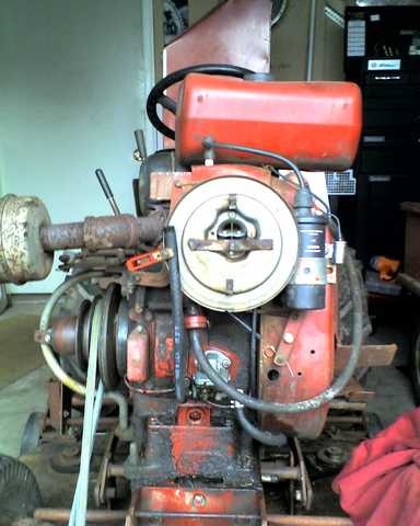

gapper 22 #8 Posted February 17, 2012 Help, I have a K241S and think my fuel pump is not working. To tell you what i have done and i have a pic showing the set up. I took another tank and ran the fuel line to the carb. Holding that tank in the air so gravity could do its thing, i started the tractor (74 B-100). I took the fuel line from the tank mounted on the tractor and pinned it up so the gas would not run from gravity. I made sure the fuel shut off was turned on and ran the tractor. FIRST QUESTION, the fuel pump should be pushing fuel out the line when the tractor is running right? If so then the pump is not working. SECOND QUESTION, If it is not working, can i get a rebuild kit? There is a number in the fuel pump housing. A-235845. This is the original fuel pump to the best i can tell. It is not plastic. I cleaned around the pump so i could remove it later. Thanks for the help and part numbers if there are any. Rick Share this post Link to post Share on other sites
TT-(Moderator) 1,145 #9 Posted February 18, 2012 Hey Rick...... The pump will work much better if it's installed right side up. :thumbs2: Share this post Link to post Share on other sites
gapper 22 #10 Posted February 18, 2012 Terry, You are saying i need to turn it 180Deg. So the arm might not be riding on the cam at all. If i look at an 8 hp kohler i have in the shed would that be the same? Thank you very much for the help. That is one of the hazards of getting something someone else worked on. Rick Share this post Link to post Share on other sites
Martin 2,133 #11 Posted February 18, 2012 yes you need to turn it 180. you need to feed the arm in first and as the pump goes up to the block, you will feel it riding on the cam lobe. both the 8 hp and this one should look the same from the outside, and mount the same way up, but the 8 should be a pulse pump which works off the crankcase pressure/vacuum to pump fuel and doesnt have an arm. Share this post Link to post Share on other sites

TT-(Moderator) 1,145 #13 Posted February 18, 2012 @Rick: You will also need to make sure the hoses are correctly attached to the fuel pump. Most pumps are labeled "IN" and "OUT" where the fittings screw in and some had directional arrows. Because yours is upside down, the hoses might be backwards. Share this post Link to post Share on other sites
gapper 22 #14 Posted February 18, 2012 WOW!!! What a deal. I am going to check this out VERY soon and see what is going on. When i change the pump the right way, It should pump fuel out the fuel line when running right? If it does not then i will need to rebuid it. Is there a rebuild kit for my pump? I think i will run home right now and have a look. Thanks for all the help to everyone!! Rick Share this post Link to post Share on other sites
TT-(Moderator) 1,145 #15 Posted February 18, 2012 Kits are available, but I would flip the pump over and try it first. Share this post Link to post Share on other sites
gapper 22 #16 Posted February 18, 2012 THANK YOU ALL !!! I did flip the pump and boy does that make a differance. She is working great!!! Share this post Link to post Share on other sites
