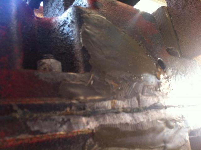

Hodge71 664 #39 Posted January 9, 2012 Hey guys heres an update, Today I got the hydro motor out with some cussin and swearin and weeping and knashing of teeth, The hydro motor was a bit easier as I had done that once before. I crawled under the tractor for the first time since i degreased and pressure washed it only to find something awry with the bottom of the tranny. I wipe some schmeg off and jeez, that metal looks different .... so I roll out and go over the other side to get a better perspective 3/4 of the entire bottom of the tranny is made out of JB freakin Weld!!!!!! Truly unbelivable, I'm so freaking distraught again over this. It now looks like I need to purchase an entire transmission assembly because I personally don"t trust it. If it was damaged that bad, I'm sure it should be replaced. This is the straw that broke the camels back, legal action will be pursued now. I cant allow this to continue to bleed me dry. It must be made right Share this post Link to post Share on other sites

stevebo-(Moderator) 8,330 #43 Posted January 10, 2012 I would like to add the fact that JB Weld or welded/brazed cases seem to be a fix for this TYPICAL fault on the pre 76 D series. I purchased my auto 18 with loader with the blown rear end. I did my research and found a replacement rear end from a very well known tractor shop on ebay that parts out our machines all the time. It was listed as "in good working order". After purchasing it and paying freight to get it to my house I found this rear end was the same as yours-repaired case. Like TT said in the earlier post these early D's had a poor design with the non hardened bull gear bolts. I would venture to guess 25-50% of them have been repaired. I understand your frustration however I would be more upset with myself if I were you rather than the other member who sold it to you especially after he offered to take it back. That just does not happen outside of the RS community. I had a deal to sell a KT17 to a member here and helped with hauling for short money with another member. The guy who bought the motor had it for about 2 months and once he figured out it did not fit his application he wanted me to take the motor back and refund him his money. On top he wanted me to give him the money back he paid a 3rd party to haul it for him? That was another situation in which the buyer expected me to know that the motor would not fit his application. After that situation I tell every buyer to do his own research and check out the item BEFORE he/she buys it. I ended up giving him his money back but I have to say I would not have if he was not a member here in our community. He was one of the members who joins for some quick information/was looking for something then I have not heard from him since. I have dealt with the member who you purchased your tractor from and have to say he is a stand up guy and not in a thousand years would I believe for one minute that he knew of the issues you were going to have. Like Sparky said if he were to purchase a tractor with the intentions of flipping it he would not do a complete inspection/test of the machine nor would I. IMO it is better to know less and let the buyer do his/her own inspections. That case may be fine as is for a very long time to come... Share this post Link to post Share on other sites

stevebo-(Moderator) 8,330 #46 Posted January 10, 2012 Jeff, The 76 and newer trannies had the brake drum set up vs the pawl style parking brake, it may fit in and be usable(not sure on that applicaiton) however you will not have use of the emergency brake. To clearify, I REBUILT my pre 76 tranny using 3 different rear end parts. I would look for a good used pre 76 rear end that has never had any broken cases. Then I would take my time and open it up, check everything and at min. replace the 4 non hardened bolts with hardened bolts. I used grade 9 even though the upgrade called for grade 8. Honestly you can pick them up cheap if you look hard enough. I paid next to nothing for one of mine on line but shipping was up there. Good luck! Share this post Link to post Share on other sites
