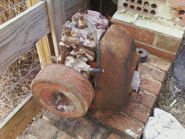

Also I have the original 4hp Kohler engine that is in really bad shape, but if someone can use it or parts from it let me know. It will only cost shipping otherwise it will be trash eventually. I can get pictures if needed.

Man that’s just what I needed, I cant thank you guys enough. I couldn’t build this thing with out this site and all of the members. I’m going to try to put pictures of the engine that I don’t need, I hate to see it go to waste. Thanks again

I like to keep these kind of motors for parts. Mamely the carb, it that Carter N is not all rotted up, its worth keeping.
eibbed
I could definitely use the air breather off of your motor for my original 4hp Kohler that I am trying to save.
