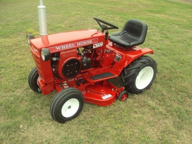

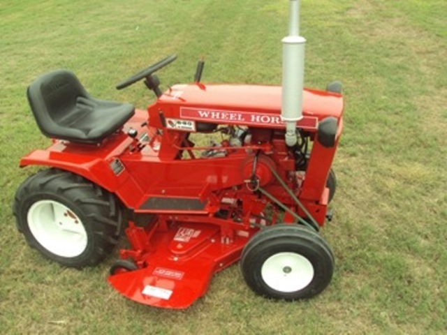

pictures of 1974 B-100 restoration
608KEB
I have a ways to go.
Kelly
Looks like it was pretty clean, or has it been painted before?
608KEB
I bought it in warren IL. The former owner had it since 78 or 79. He rebuilt the motor and painted it about 10-12 years ago. The paint is really nice. The problem was he used it only to plow snow and probably didn't keep it clean. I went back and forth for months about deciding to restore it. The rims were painted silver and it has the wrong decals on the hood. This is the first restoration I've ever done on anything. I had a WH about 30 years ago...used to mow lawns in highschool. I also bought a 75 B-80 4spd last summer. I'm going to use that on a regular basis. The B-80 was a one owner from KS. came with a 36" rear discharge deck and a 42" plow. Both tractors must have been kept inside. K.B.

Kelly, that is a sharp looking tractor!
I have a 1975 B-80 (8 speed), and a 1975 B-100 Auto....neither one looks as nice as yours!

Nice start, keep the pics coming.

If my restoration turns out like yours, I would be very happy. Your B-100 looks great!

looks great so far! :handgestures-thumbup:

They are some nice looking tractors, all done up. :icecream:
