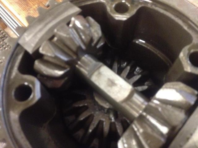

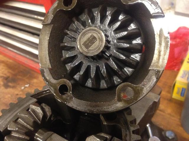

Martin 2,133 #11 Posted December 12, 2011 Got the differential apart. Couldn't see any excessive wear or anything that stands out. The bevel gears look like they have hardly any wear at all. So what do you guys that know these things think? Share this post Link to post Share on other sites
racinfool40 202 #12 Posted December 13, 2011 :handgestures-thumbupright: Looks Good to me Martin!!! One of the better one's I"ve seen!!!! Looks like your goin in the right direction!!!! Share this post Link to post Share on other sites
sorekiwi 761 #13 Posted December 13, 2011 A little too hard to see what the teeth look like in the first picture. WH isnt known for a fine finish on their gear teeth anyway! Everything in the second picture looks good to me too. Neither of the diffs I pulled apart had that mark on the end of the axle, I assume it was floating in far enough to hit the pin through the spiders. I dont think it is an issue though. Have a good look for cracks in the outer housings of the diff, both of mine were cracked, but they were big, clearly visible cracks. I'd also look closely at the flanges on the thingies that retain the pin. In the pictures I posted above you can see where mine were broken. Also my outer housings and the ring gears on both of mine showed signs of fretting where all the bits clamp together. I dont see any signs of that in your second picture. Share this post Link to post Share on other sites
Martin 2,133 #14 Posted December 13, 2011 The only thing questionable that I seen inside there is the slight play I noticed in the gears. It's not bad, but there is some there....I've got it back together now and really think that I need to leave well enough alone though........ Overall I'm happy this was a good outcome, let's hope there's a few years left in it..... Share this post Link to post Share on other sites
sorekiwi 761 #15 Posted December 13, 2011 The only thing questionable that I seen inside there is the slight play I noticed in the gears. It's not bad, but there is some there It provides some clearance for some oil to get in there! Share this post Link to post Share on other sites
Martin 2,133 #16 Posted December 13, 2011 Neither of the diffs I pulled apart had that mark on the end of the axle, I assume it was floating in far enough to hit the pin through the spiders. I dont think it is an issue though. mike, that mark on the end of the axles ( it was on both of them) i couldnt find where on the pin it could have made that mark by rubbing. in fact the only rubbing marks on either the axle or the pin was some slight circular ones in a bigger diameter than the square shape of this mark (like the end of the axle).... this small square shaped mark was recessed slightly in the axle, but the pin was smooth, its hard to see the pin on the first pic because of the focus, but the slight darkening is relatively smooth and center, whereas that mark in the axle is off set. could this have been in the end of the axle already? maybe the axles were swapped from another diff earlier on in its life, or maybe they have always been there? who knows......... Share this post Link to post Share on other sites
