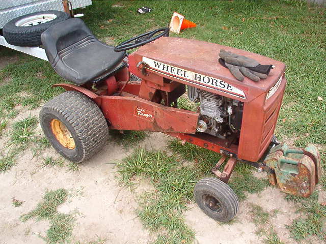

Anyone want to take a wack at identifying "Patches" my "all original" Lawn Ranger.
Should make for some Sunday fun !!!
jusjeepn
I'm gonna say it was 1963 33E simply because of the missing foot peg on the left side.
HorseDrawn
So I jumped on 33e here and the hoodstand/dash area look completely different with no where for the fuel tank through it. Mine has the bolt on rear wheels. I'm not even sure if its a Lawn Ranger at all?
Gene_S
I'm with Pat here...
HorseDrawn the hood stand is a lawn ranger with added amp gage and the dash and hood are scabbed on off of another tractor... And the steering wheel appears to be a Cub Cadet wheel...
jusjeepn
Yes i noticed the taller shifter but could not see the 3 lug wheels. I'd still say the frame and at least the rear fender/tool box are 33e. The hood stand could be 63/64 because it appears to have used a bolt on single or 2 piece fuel tank but does not have the holes for the key switch or the starter switch that the 33e used. Your dash and hood looks like it could be from an A90. Your trans could be from a 65-67 L/R. Quite the Frankenstein you have there!! I like it!
fabricator2009
I will say 63 lawn ranger because of the missing foot pedal and the pnuematic front tires. the '62 rangers had semi pnuematic fronts.
TT
Tire & wheel combinations aren't very credible when it comes to identifying old Horses. (the rears are "wrong", so the fronts could be too)
The chassis is either '62 or '63 Lawn Ranger. The ID sticker is covering the starter button hole, so it was probably a recoil start tractor - 32R or 33R.
@HorseDrawn: What is the serial number?
HorseDrawn
Serial 62-17190
TT
Here is the serial number from the '62 32E that I had:
My hypothesis would be that yours is also a 1962.
