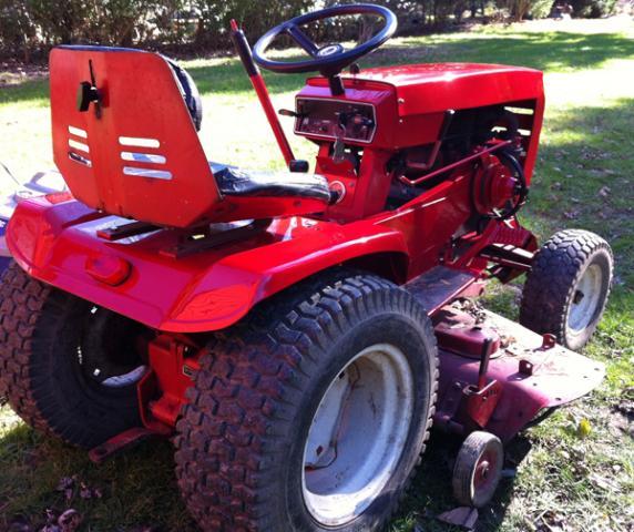

As I said earlier, I humbled by the quality of restorations done here - and the pride people take in doing it right. So, I debated whether or not to post a picture of my first attempt - but what the heck.
post-4385-0-05730900-1322909077_thumb.jp
Mechanically, she's in fairly good shape now. Smokes a little on startup and sometimes under load. Tranny is leaking a little, but shifts through all the gears. Carb works pretty well now that it's back in adjustment. I'm going to pull the engine this winter and do an overhaul and a carb rebuild. Tranny is a little scary - hoping it's just a leaking drain plug or a bad gasket.
The deck was a real live disaster. New top bearings, new center shaft and a new center pulley (ouch). Still needs a weld where the adjusting handle attaches.
The fender pan is not a stock C-100 part. The original is in such bad shape, It's going to have to wait until I can teach myself how to do some body work. Judging from the condition of the fender (and bent seat springs) I suspect that at some point the ol' girl was rolled.
This is a working tractor, so as I removed something to paint it, I'd put it back on and resume mowing. The drawback is you can't paint parts like the frame or the engine without ripping it all the way down, and I ain't going back to a push mower - the property is just too large, and I'm just too old. I'll do a tear-down this winter.
This is the first of anything I've ever painted (and before I was finished, I had taken the hood back down to metal twice - the result of a nasty clear coat experiment.) Lots of cans of Valspar IH red. I don't really like the out-of-the-can finish (maybe I'm doing something wrong, but it always results in a lot of orange peel) so every part has something like 8 coats with lots of wet sanding between each round. The final coat was wet sanded from 600 through 2000 grit paper, then rubbing compound and finally polishing compound. I actually love the sanding part. Very therapeutic. Zen-like.
First sign of warm weather, I plan on a final once-over with an orbital buffer, and then a few coats of wax.
I haven't done the seat yet. I keep thinking I'll bring it to an upholster. But I'd have to do that under cover of darkness or risk the top of wifey's head blowing off. As a side note, wifey is really into knitting and offered to knit me a tractor seat. I passed on that - but a full-size tractor cozy would be nice.
As I get to the end of this project (yeah, there's still a lot to do) I can easily see why lots of guys here have more than one. Wondering what the heck I'll do with my time once this is finished. My goal right now is to have it complete by July 4th. Our little town has a parade each year and I'm going to show it off. And if they won't let me in, I'll paint it black with the words "Eat Me" on it, and crash the parade from a side street. That would be the only scene from "Animal House" I haven't actually lived yet - so I'm looking forward to that.

I think it looks great for a first resto.

Tranny is leaking a little, but shifts through all the gears. ... Tranny is a little scary - hoping it's just a leaking drain plug or a bad gasket.
How much is "a little", and from where?

Just noticed a couple of drops on the barn floor. Been meaning to look where it's coming from, but haven' gotten serious about crawling around trying to locate it. Got any ideas?

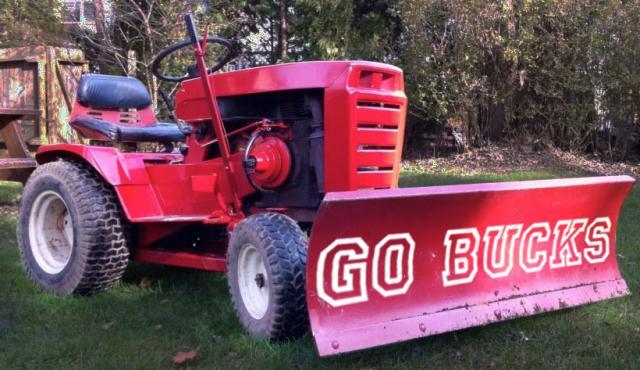

I forgot to upload a picture of the new plow I just got.
post-4385-0-92327100-1323028140_thumb.jp
When I'm finished, those wheels will be a nice shade of gray.

Sure, anything to help a fellow addict. :)
A couple of drops is probably minor, but it's best to keep an eye on it to see if it develops into something more major. Make sure you keep the fluid topped up in the meantime.
I would clean the outside of the trans the best you can, dry off any wet areas so you can tell if they get wet again later. Pay special attention to:
  • The rear axle (both sides);
  • The drain plug and the smaller plug in the top/rear area of the left axle housing;
  • Behind the brake assembly (left side, can be difficult to reach & see);
  • Behind the transmission drive pulley (right side, likewise);
  • Around the gasket that seals the two halves of the trans case.
Once it's clean, you can drive it around for 15-20 minutes or so until the fluid is nice and warm, park it, and put a clean oil drain pan or something similar under the trans to see how much is collecting and where (a clean sheet of cardboard works well too). Then come back later and see what you have.
You say it's shifting well, that's a good sign. Any unusual noises or trouble getting it into any gears, or popping out of gear?
Have you changed the trans fluid since you got the tractor?

Thanks! I'll be looking carefully for where it's coming from.
Changed tranny fluid first thing this spring. Fluid level appears ok.
Sometimes I have to "double clutch" to get it into a gear. In other words, depress the clutch pedal, try to ****. If it won't go in, let up on the clutch and re-clutch - always goes into gear on the second clutch. I've never tried shifting on the fly - I always shift when the tractor is stopped. It's never popped out of gear.

Pete,
How did your old fluid look when you drained it? Milky/bubbly or rusty at all? Either of those would indicate water had gotten inside the trans, probably through the shifter area, you'll want to make sure your shifter boot is in good shape, replace it if necessary.
The "double clutching" is a fairly common ailment, I have to do that on both of my tractors occasionally to get it to slide into gear nicely. I don't know what it indicates exactly, but I don't think it means anything serious on its own, I'm hoping others will chime in here.
And you're right to shift ONLY at a dead stop, never while moving.

Fluid was not milky or rusty-colored - no indication that water was in the housing. As far as I know, the previous owner kept the tractor in a shed. But the shifter boot was trash, so I recently replaced it.
Really glad to know "double clutching" is common and not an indication of some impending disaster.
As a side note, when I got the tractor, it was missing the drive belt cover, and shifting was impossible. I had to actually shut the machine down, shift, and then start it up again. But the minute I found a pulley cover, it was as if I had located the holy grail. Not sure of the physics involved, but running it without the belt cover is impossible. I figured double-clutching was the price of admission.

The belt cover actually helps stop the belt .
Belts can be tricky, sometimes if a belt is stretched too much, the extra slack "slapping" around can cause it to pull on the pulleys.
In the same brath a brand new belt can be stiff and sticky & will sometimes be tough shifting until it gets some time on it.
The reason a tractor doesn't shift is due to pressure on the gears, something is still "engaged" either the pulley has some pressure on it or the gears are just engaged into each other. If you use the brake to stop the tractor, that can leave the tranny in a bind, sometimes just a little roll backwards will disengage the gears, or just the physical act of releasing and pushing the clutch along with re-engaging and disengaging the input "juggles" things around enough to let the tranny catch slack enough to shift.
If it is extremely hard shifting, you could have a worn shaft or gear that gets hung up, but most cases there is really nothing wrong in the transmission.

Good to know, Rooster and thanks for the detailed explanation!
