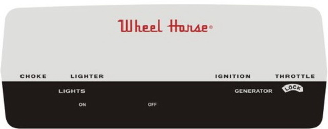

I was wondering if anyone has a good picture of an original dash on a Commando 8. Am I correct in assuming that this is the right replacement decal for the dash?

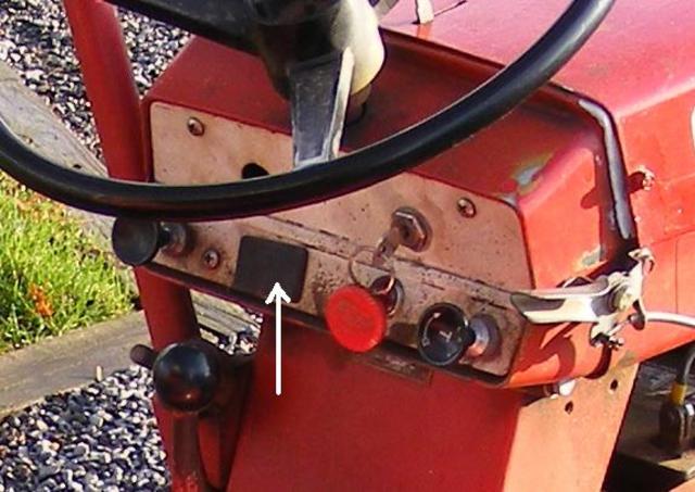

Is the item shown below with the arrow just a blank or cover for a non-existent light switch? Did the Commando 8 come with a lighter standard, or was it optional?

Light switch for standard headlights. I would post a picture of it but I am in Detroit, MI at the moment. I can send a picture of my Commando 8 when I get home.
Similar to this switch (not the dash plate obviously), but with a chrome tin bezel ring around the switch:

I remember that dash. That's on the 800 Automatic that I picked up for you, right?. The original dash on the Commando was not plastic according to the parts list, and there was a blank plug where the light switch would have gone, Does your Commando 8 have an original metal dash? When are you coming back from Detroit? You could stop in Williamsport on your way home and pick up the Commando for me. :ychain:
Looks like mine is pretty similar to yours Bob. Light switch blocked off, and no lighter when I got it. Original or not, lights and lighter have been added since. Still looking for the correct switch though. Terry do you have the pictured dash decals currently available on your site?

The '67 867/1067/1267 models and the '68 Commando 8 list # 7222 as the correct dash panel.
The # 7379 dash panel was used on the '68 Raiders and the Commando 6 :scratchead: - which is this panel:
I have no clue what the difference is. :confusion-shrug:
The lighter was standard but lights were optional on the Commando 8.

I BELIEVE THE LIGHTER CAME ON ALL THE COMMANDO 8 BUT THE LIGHTS WERE AN OPTION

You have the correct decal in your post. I'm looking at my original dash right now. On my Commando 8 which was bought by my parents the lighter came standard. Mine has the black cover where the light switch goes.

The decal that you have listed in your first post is the correct one for the Commando 8. I just finished my Commando 8 and that is what I have along with the black plastic cap to fill the light switch hole. Mine came with the escutcheon plate.

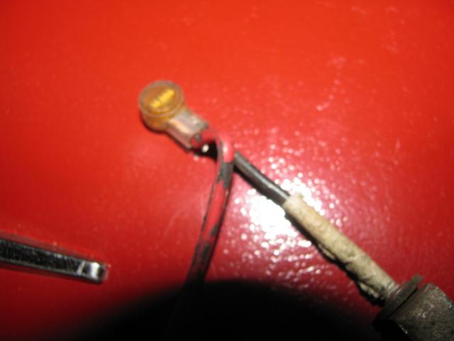

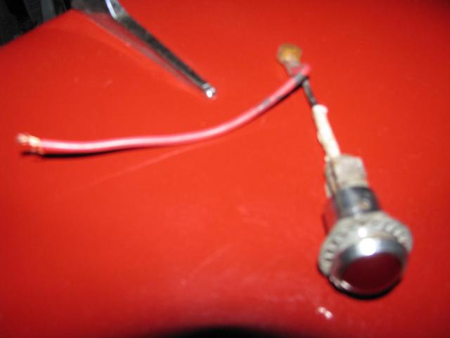

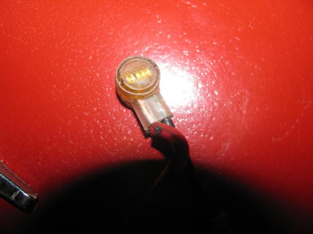

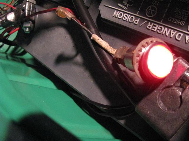

Interestingly, my Commando 8 has a generator light red lens, (with no bulb or wiring), and if you look at the wiring diagram for the Commando 8, there is no wire for the light, and in the parts list, no lens, or bulb.
Mine, for reference.
post-3498-0-70042300-1331167818_thumb.jp
post-3498-0-86879900-1331167848_thumb.jp
post-3498-0-48190200-1331167870_thumb.jp
post-3498-0-39707500-1331167903_thumb.jp

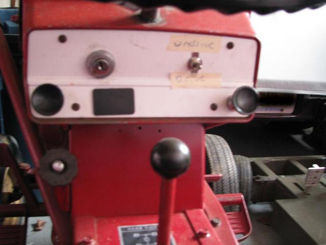

I have a 1972 commando 8. no lighter

I know things may be changed over the years but my dash did not look like it was touched at all in the 44 years it has been in existence and had the red generator light with all of the wiring, and still works today. :)
