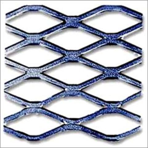

MalMac 1,332 #346 Posted November 9, 2012 Duke is it possible to fab a grill type of guard to protect it from bottom to top. I know just about fabbing anything is possible but how practicable? A full grill painted black with a red tank and possibly a Horse Head cut out put on the grill? Share this post Link to post Share on other sites
HorseFixer 2,013 #347 Posted November 10, 2012 Tim, I picked up some diamond shaped expanded metal grill material today and checked my inventory of steel and angle Iron and I think I have everything I need to protect the tank. Since this is your idea then I think I should send you a bill of materials and labor. oh and a cost of a few qts of apple juice to loosen me up! So my welds look better. Craig how did you know I was gonna add a secret compartment to store me juice. should have some pics of progress by Sun. Cheers ~Duke Share this post Link to post Share on other sites
MalMac 1,332 #348 Posted November 10, 2012 Now i know that buying that diamond plate was like buying real diamonds. Hey as far as my idea, you have to let my relish in the thought that maybe I had a good one. They don't come around very often. Most of the time my ideas seem to always turn around and feast on my back side. IE. (Bite me in the A&%) Back to the juice I need to be making the trip up that way. My jar, she be a empty. Share this post Link to post Share on other sites
HorseFixer 2,013 #349 Posted November 10, 2012 Tim, Diamond Plate? I thought I said diamond expanded metal? Not a plate full of DIAMONDS! :ychain: Share this post Link to post Share on other sites
HorseFixer 2,013 #350 Posted November 11, 2012 Ask and you shall recieve. Tim talked me into a GRILL, did some thinkin, and yes that was a great Idea. I cut and tapered the main support rails and when I rebolted them back on I made sure they were square, actually I used a square as I needed them to be 2" from the tires so I the square worked as a good straight edge and was 2" wide itself. After I had them square I slid the straps on the tank so they would be correct on the rails. I Then removed all the plugs and replaced with Brass plugs and used teflon tape. I then had to dril a 1" hole in the tank support Z rail to run the fuel line through which will be all brass fittings with a 1/4 WOG ball valve. I then went to work on the protective Grill and decided to make a trapazoid shape. I figued the angles needed and spent time on Mr. Horizontal Band Saw. I then clamped everything together and Turned it over to Mr. Lincoln's where some was Tiged and some was Migged. Here is what she looks like, Complete with a Horse Head Tim mentioned. Tomorrow will be 66 deg so looks like the painting will be done! If ya like what Im doin give the Ole Girl a Vote Thanks ~Duke 1 Share this post Link to post Share on other sites
