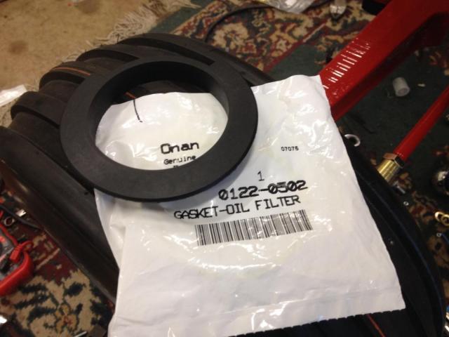

608KEB 796 #33 Posted August 23, 2014 Where do I pick up the rubber seal that goes around the oil filter? Share this post Link to post Share on other sites
Martin 2,133 #34 Posted August 23, 2014 (edited) Onanparts.com is where i got mine, part number is below. you can get them through toro i think, but not 100 % on that, not sure on the toro part number though..... Edited August 24, 2014 by Martin 1 Share this post Link to post Share on other sites
