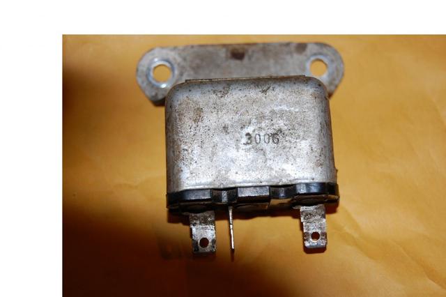

So this is where I need some true expertise... On my 1987 WH 310-8, I have not been able to get it started after I accidentally shorted out the ignition trying to repair the chain for the deck (insert rookie comment here). Anywho - I FINALLY traced the problem to this relay. I believe this is the culprit as when I remove all 4 wires attached to the relay together, the mower wants to start. The only issue is that I have to have the blades engauged to start. So - my questions are -
1) can anyone supply me with a part number for this relay?
2) Is there any way to test this relay to see if it works? I already connected the case of the relay to the battery and the terminal on the far end to the positive - and it clicked, but I got no power to the other two posts...
3) Also - any thoughts as to why the PTO has to be engauged to start the tractor? Its entirely possible I reversed a wire in my haste to get this thing started... any thoughts?
Here is a pic. It says 3006 on the steel and H B S on the three leads coming off.
You are close - very close on this one. Tim was giving good advice pointing you toward one of the possibilities which can cause intermittent starter operation. Corrosion on the relay case or on the tractor frame where the relay mounts is a valid reason for the issues you are seeing. It is correctable by cleaning the relay case and the tractor frame at the mounting area.
The case of the relay is metal and the case bolts to the chassis - so the case should be grounded - electrically connected to the battery negative (-) terminal. You have already identified the trigger terminal and activated the solenoid - you do have the polarity reversed (case should be negative and trigger terminal positive) but that will not corrupt your troubleshooting. Your confusion is due to the expectation of voltages being seen on the two remaining relay terminals.
Even with the relay activated, battery voltage will not be present at the other two relay terminals. The function of the relay contacts when activated will be to make the remaining two relay terminals short together. This is identical to the function of a starter relay but the lockout relay is not designed to carry heavy current - just a few amps at most to energize the starter relay.
So with the relay wired directly across the battery terminals and energized, the remaining two relay terminals should show near 0 ohms resistance with an ohmmeter. When you remove the battery positive jumper from the relay, the relay de-energizes and the ohmmeter should show a high (meter in overrange) resistance.
The diagrams below demo the principle described above. The relay shown is a starter relay but the lockout relay is IDENTICAL IN FUNCTION - it's just not designed to carry heavy current thru the switch contacts like the starter relay.
Boston Horse
SOI - you are a man among men - I love the diagrams - very helpful. So - I just put the negative from the battery to the case of the relay, the hot from the battery to the trigger terminal on the relay (far right stud, labeled "S") and I checked for Ohm's on the remaining two studs. Drumroll please... nothing. I hear the relay clicking but there is no change in Ohm's at all on the remaining two studs. Can I get my shovel out and bury this relay yet or is there something else I can do? More importantly, where can I get a new one? I can't believe that a silly mistake like sparking the ignition killed this relay... but it must have. Also - does this relay have anything to do with the PTO switch? For some reason, when I connected all the relay wires together, the tractor only starts when I have the blades engagued? Is this related to the relay or do you think I put a wire on backwards elsewhere? THe PTO switch has 6 terminals, but I am only using 4 of them. Do the wire orders matter?

Save Old Iron
You could remove the metal case from the black plastic base and inspect the contacts. They may be able to be cleaned like ignition system points.
The world of serious tractor fixin' hangs in the balance as we await your next move.
Boston Horse
CASE CLOSED!!! SOI - you were right. I was able to open up the metal case on the relay by prying the crimps open and unsoldering the ground. When I looked at it, I noticed that the points were clean, but they were not touching under load... so I simply bent the tab a hair and got them to touch. That was it. I have been staring at wiring diagrams and RS discussions for 4 days, laying under the tractor in the garage for just as long and testing every inch of this machine to be fooled by a relay that was not making contact... PROBLEM SOLVED! I have no idea how this tab could have bent when I shorted the ignition, but it did, and its all set. With regard to the tractor only starting with the blades engauged, I took KPINNC's advice and checked the two switches on the PTO switch to figure it out, and that is all set too. Victory!!! Thank you all for your help!
Save Old Iron
Yep, you can make the problem and the troubleshooting sound as sexy as you want ... but the fixes are generally very simple. I congratulate you on your stick to it attitude and the fact you were willing to do an autopsy on the defective part.
I fully expect you to be one of the folks who chimes in on the next post that requires help in this area. You are now the official RS relay adjustment expert.
BTW - a little clarification on the B H S terminal designations - the relay you repaired is the classic style "horn" relay used decades ago in automobiles.
