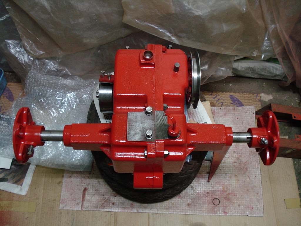

The Engine is sorted now I have replaced all the missing/wrong screws/bolts , bit of work to do on the Flywheel and Shroud. I have a New Starter for it.
The Transmission is back together and the new expensive Hubs are done ready for me to make some New Woodruff Keys. The Hubs are very good condition and correct for this Model. I will convert to H.T Bolts and Acorn Closed Wheel Nuts-
I've been gathering parts together ready to hit it hard at the end of the month, so I can at least reach the Rolling Chassis point in February.

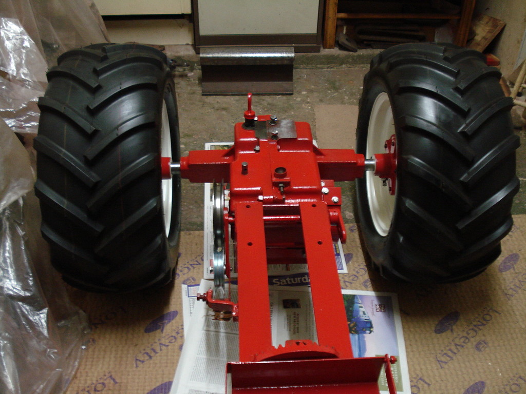

Wheel prep is priority, Grit Blasting and Powder Coating (not me), then I can put the 'Fat Ags' on them.
I will have some welding to do on the Sheet Metal, but nothing serious or major . I'm not a Welder, but I know a man who is and he's ok for training me up on the Practical.
This will come in Handy , as I've got a Lump of Railway Track which I plan to use as a Front Weight type Bumper !.

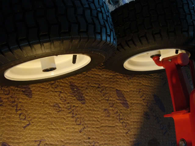

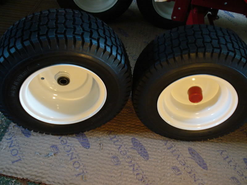

Front Wheels done ( on left in the 2 pics).... Another reason why this is not a Resto. These Refurb wheels are Post '76' (compared to my pre 76 on the '72' Raider> right).  I had one 6.50" x 8" and one 4.50" x 8" on the C-120, so I'm using these for now, until I can find another 4.50" x 8".
The Refurbs will increase the Front Track width by 2 inches due to the Offset, so I'll see if it's an issue later

meadowfield
  Anglo Traction said:
Front Wheels done ( on left in the pics).... Another reason why this is not a Resto. These Refurb wheels are Post '76' (compared to my pre 76 on the '72' Raider> right). I had one 6.50" x 8" and one 4.50" x 8" on the C-120, so I'm using these for now, until I can find another 4.50 x 8".
The Refurbs will increase the Front Track width by 2 inches due to the Offset, so I'll see if it's an issue later.
ahh,
my raider has two different front wheels, the dish looks different on both - I've never measured them but is this the same odd apiring as you?
Happy to swap providing either wheel is any good!!!
mark

Hi Mark, I'm not sure what you have?. If one of yours look's like the the ones on my Raider 12 (on right of Pics), then I do have one of those (6.50 x 8").
I'll have to check the condition, as they're holding up my Tranny at the moment.
Do you have a Narrow 4.50"wide x 8"Dia Rim?. I'm looking for one.
meadowfield
Richard,
I have no idea what they measure, but one of them has a deeper well/flange where the bead would sit on the outside edge. It's very noticeable when you look at them side by side.
I will measure and picture when I get back home on thursday.
They do look very similar in terms of mismatch to yours, but then they have been on opposite corners of the tractor and a side by side comparison is difficult :banghead:
mark

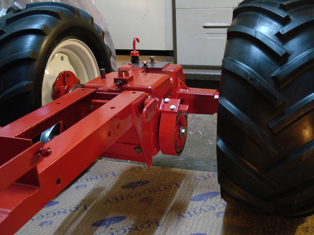

I've done the main frame and married up the Tranny, machined the Woodruff Keys and set the Hubs on. I placed a Nylon Washer on the axle behind both Hubs, just in case the Hub(s) move in without me noticing to protect the Oil Seals.
Wheels were finished last week and had the tyres fitted yesterday.
Purchased a new Clutch Idler Pulley from U.S as the bearings were sloppy on the old one. When I checked the new one on the Tractor, I found the Spacer Boss was too big and was out of line by 3/32", so I had to press it out and machine it down. As you can possibly see in the pic, it lines up correctly now (Aftermarket purchasers beware). The piece of Railway Track in the background is going to be a universal Weight Front or Rear (36lb as it is)

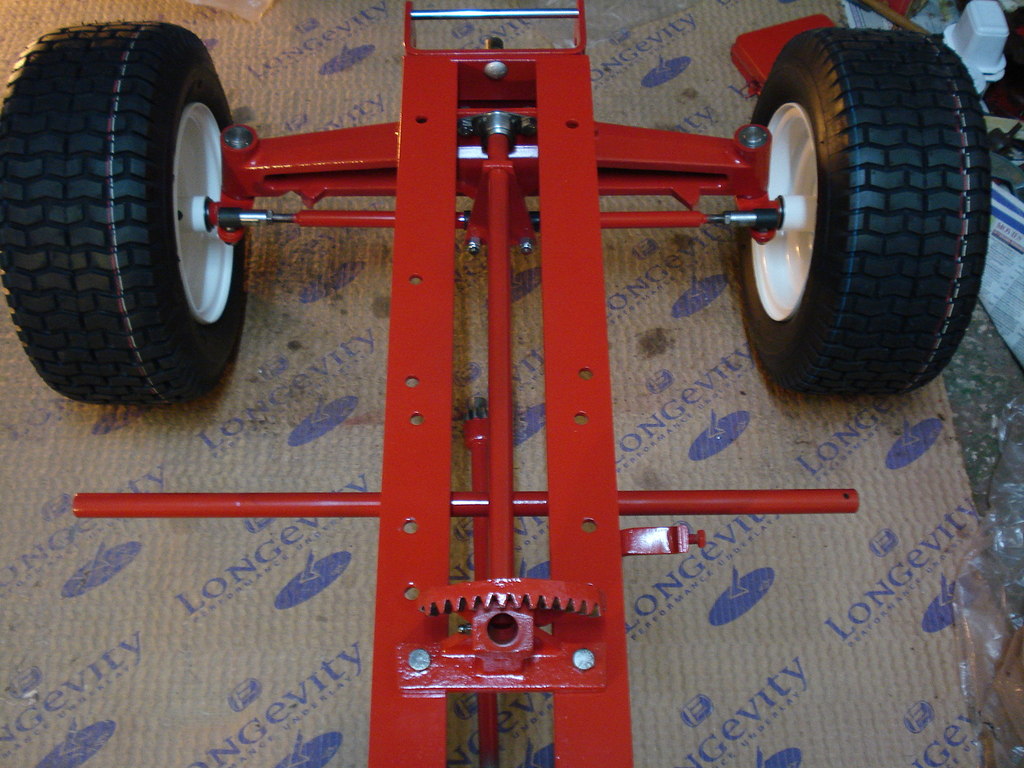

On the front end in the next pic , I've had to replace the Spindles and Axle (thanks Michael) due to excessive wear on the originals. New S/Steel Lock Nuts on the Rods which I have refurbished to eliminate the 'play'. Also refurbed the Flange Bearing and sealed it with a foil gasket behind to keep dirt out.
I also found out why this Tractor had adjustable Steering Rods fitted. The lower Steering Rod end plate (the Rods fix to) was welded out-of-line with the Quadrant on the back end, so fixed length Rods would not fit, or would not allow equal lock/turn limit !. With the Offset of the Post '76' wheels fitted, it may give me a problem with Lock limit on left turn. When I find some narrow Rims, I will replace them and maybe chop/re-align and weld the Lower S/Rod-
