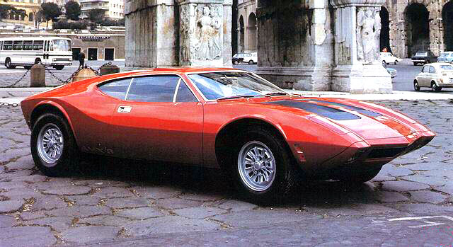

AMC RULES
All this is very interesting information. I'm thinking that with AMC ownership and Renault's influence, the D250 was the result for Wheel Horse. I wonder what would happen if, during AMC ownership of Wheel Horse, AMC had a partnership with Ferrari!!!
The fruits of AMC's Italian partnership led to this Bizzarrini bodied AMX/3...
So, you can imagine what their joint venture tractor would have looked like.   :scared-eek:   :handgestures-thumbsup:
http://www.foxnews.com/leisure/2013/02/11/rare-amc-amx3-prototype-on-display-at-chicago-auto-show/
http://mycarquest.com/2013/08/amc-amx3-by-bizzarrini-for-sale-a-bizzarrini-developed-super-car-powered-by-american-motors.html
