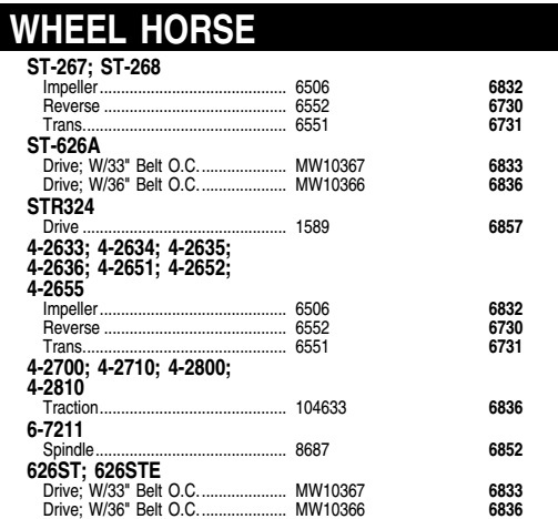

6506 is 4L x 31.91" or 1/2" x 31.9".
If any run over flat idlers make sure you get the green belts for them other than the BladeRunner.
Found an actual listing at Gates so best go with them which is what Napa carries.
Garry

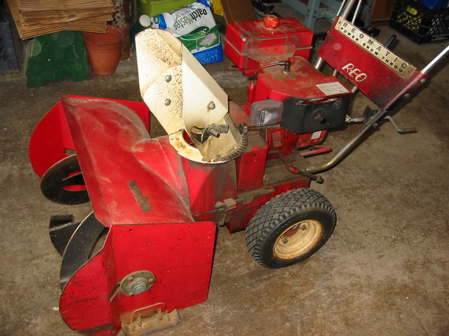

Just picked up the ST-267 for myself. Needs work but will blow the white ugly cold wet stuff without any additional work if needed.
I'm starting not winter yet but just 'round the corner, yuk.

Wow. She's a beauty. Looks brand new. It even has chains. I'm jealous.
It has some new parts on it I see. New guides and auger bearings.
If you replace the belts go with Gates only and search eBay for American made ones. I tried Dayco and it just ate them. I went through that 10 feet of snow winter we had with one set of Gates belts. This is the last snow blower you will ever own. Mine is 51 years old with no sign of slowing down.
I did the impeller mod. It helps with the clogging.

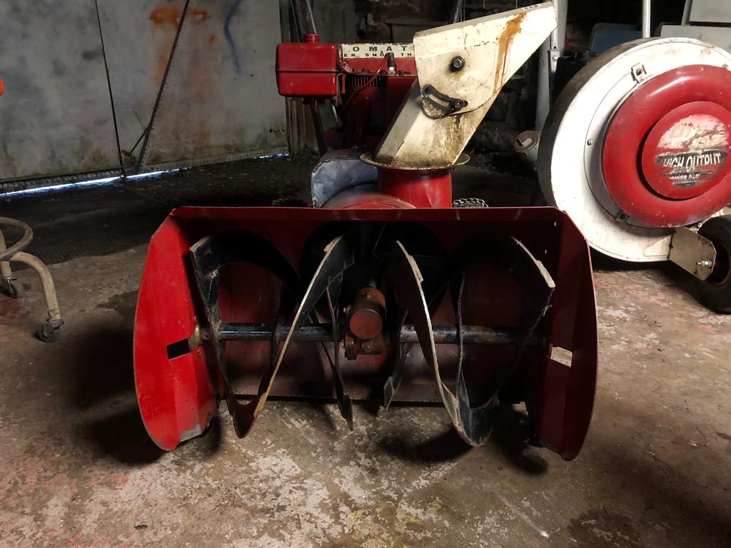

Old thread I know. Looking at one for sale now that appears to be a 1969 model.
WHX??
Anything older than 1970 is worth a look in my book.
:WRS: Consig
Consigliere
WHX24,
Thank you. I just purchased it yesterday. 1969 REO Wheelhorse Trailblazer 7. The better I am prepared for winter the less likely it will snow.
