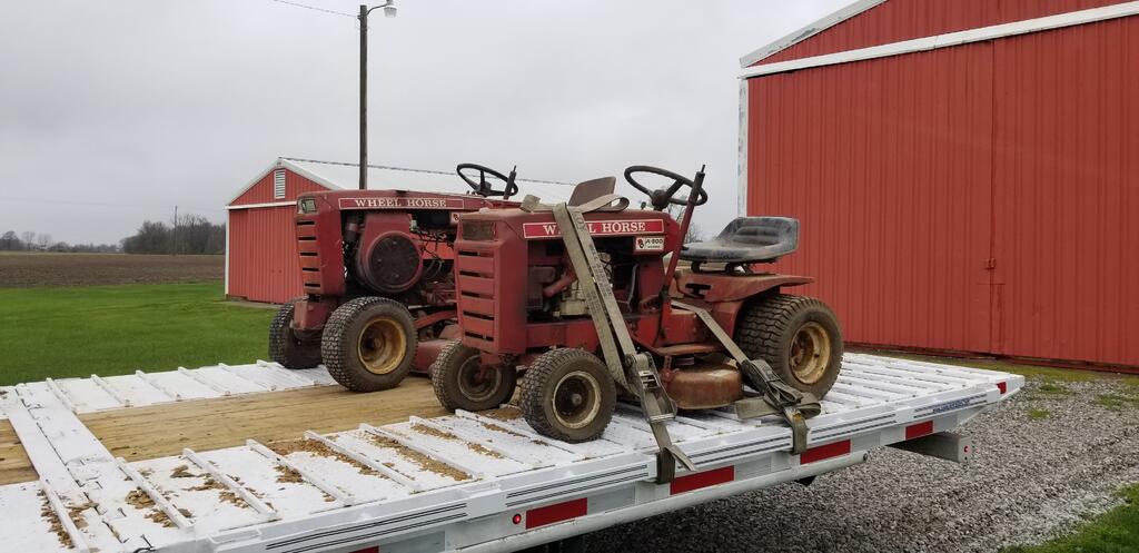

Wheelie Horse Guy 0 #5 Posted October 8, 2021 Hello gang, first time posting on here. I recently picked up a C120 Auto and a A800 Ranger as a package deal from a local farmer. Both were complete mowers with decks....so I thought. I got the C120 running and cutting and the parts are easy to find, but the A800 Ranger did not have a carb on it. Can someone tell me the carb # for a A800 Ranger Tecumseh motor? I cannot find parts for this mower as easily. Any advice would be appreciated!! Share this post Link to post Share on other sites

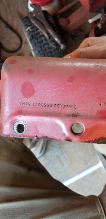

Handy Don 15,167 #6 Posted October 9, 2021 2 hours ago, Wheelie Horse Guy said: Hello gang, first time posting on here. I recently picked up a C120 Auto and a A800 Ranger as a package deal from a local farmer. Both were complete mowers with decks....so I thought. I got the C120 running and cutting and the parts are easy to find, but the A800 Ranger did not have a carb on it. Can someone tell me the carb # for a A800 Ranger Tecumseh motor? I cannot find parts for this mower as easily. Any advice would be appreciated!! Congrats on you find and welcome to the forum. I don't thing the Files section has manuals for the A800. What is the model and serial of the engine? Should be on the flywheel shroud. Aftermarket Tecumseh carbs are pretty readily available if you can narrow down the engine model and serial. Share this post Link to post Share on other sites
Wheelie Horse Guy 0 #7 Posted October 9, 2021 (edited) 8 minutes ago, Handy Don said: Congrats on you find and welcome to the forum. I don't thing the Files section has manuals for the A800. What is the model and serial of the engine? Should be on the flywheel shroud. Aftermarket Tecumseh carbs are pretty readily available if you can narrow down the engine model and serial. Yes I did take a picture of said model and serial of the unit. I went to Isavetractors.com (where I made other purchases for the C120) but I couldn't find any parts for the vm80 150056A motor Edited October 9, 2021 by Wheelie Horse Guy Share this post Link to post Share on other sites
Handy Don 15,167 #8 Posted October 9, 2021 Miss Goggles will help you with "Tecumseh vm80 carburetor" the 150056A will be important to filter out the many carbs. Likely, though, that isn't the whole problem--you also need linkages that are likely not there. So the alternate is to start with the A to Z tractors in our vendors page. Call, as the phone usually gets answered and emails can be slower! Maybe someone on the Forum has the IPL for that unit and will chip in. 1 Share this post Link to post Share on other sites
