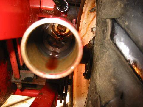

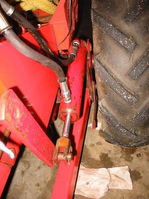

stevasaurus 23,805 #1 Posted November 23, 2009 got a 702 with a hydro type-2 lift...wanted to put the snow blade on it this winter instead of the 857. Like the roundhood. The lift works with no load, but will not pick up the plow off the ground. I do not see any leaks, and I really know nothing about hydrolics. A manual would be nice, checking Yahoo Gps for that. I guess it could be low on fluid, but I do not know how to check and what to add. Thought I would get a little more aqquainted with it today. I did a search on this site using HYDRO, got a bunch of posts but no one actually talking about the unit and how it works. Appreciate any help and advice. pulled off the unit: HEIN WERNER manufacturer...model = A4CCWH serial #42050 everyone at the show that looked at it said it looked like a HY-2...did not see that anywhere. Share this post Link to post Share on other sites
stevasaurus 23,805 #2 Posted November 24, 2009 OK...got a manual by joining the yahoo group 3...I don't know...added a tablespoon of powersteering fluid that filled up the resewvoire...so it wasn't really down.... the piston was in during the check...not extended. read the manual...checked for leaks...I have to admit, I get a drip at the low end of the piston...but I was not low on fluid, and the drip is minimal and not the cause...although I would want to fix it. I do get a hesitation about halfway through the extention of the piston...like it might be bent...although it does not look bent at all...all this with no load...I don't think the piston is bent...I think the pump sutters at this point for some reason. Don't want to point you in a direction...just let you know what I saw. Going to put the blade back on tomorrow and make sure that there is no obstructions. At this point...I'm lost...need some help. :notworthy: Share this post Link to post Share on other sites

fireman 1,022 #5 Posted November 24, 2009 Steve, I just saw this post and I will try to help you out as I have rebuilt two of the HY-2s. I would recomend pulling off the pump, hoses and piston. Believe it or not there is nothing to rebuilding them. The piston uses standard o-ring and backup washers to seal it. Inside the pump is nothing more than two gears and two shafts along with the large shaft/control that sends the fluid through the the proper passages when you move the lever. That also uses standard o-rings to seal it. It took me about three hours to take it apart, clean everything up. and replace the o-rings and backup washers. My best guess why it won't lift the plow is fluid is getting by the o-rings in the piston under load and just recirculating back into the pump. Share this post Link to post Share on other sites

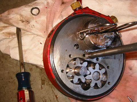

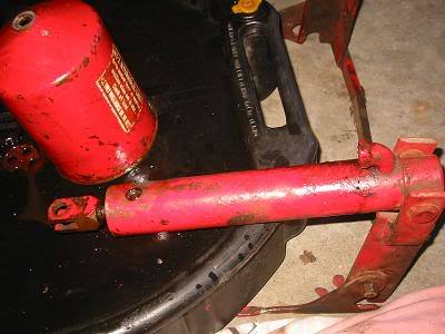

CasualObserver 3,416 #13 Posted November 24, 2009 Steve, never been inside the pump myself, but I saved these photos from a webpage I found a while back where someone photo-documented their HY2 rebuild. The page itself is not there anymore, but here's the pics from it. Maybe they'll help a little. In the upper left you will see the original 1447 seal still available but now listed under part number 5959. Before this was replaced fluid was leaking from the pulley shaft while the engine was running. Remove your front hose and fitting and the cylinder and piston can be tapped out to get to the O-Rings. Before the o-rings were replaced fluid would puddle under the cylinder. Share this post Link to post Share on other sites
stevasaurus 23,805 #14 Posted November 24, 2009 Thanks Jason, that will help alot. I think I will do a documentation of mine with pics, if that is alright. Did the trouble shooting today: the plow does fit the 702 with nothing in the way of it working the pin bolt in the lift mechanism was OK. The HY-2 would still not pick up the plow, and if we helped lift the plow, the fluid would bypass something and the plow would drop back to the ground. Gentlemen...a rebuild is in order. Please point me in a direction for parts thanks and the plow is now on the 857...let it snow...my daughter and I took the 2 horses for a ride around the block when we were done (mini-parade) got some looks and some thumbs up honks. :thumbs: Share this post Link to post Share on other sites

linen beige 16 #21 Posted November 26, 2009 I think they were $25 a piece, fireman...I think Jobob said he bent his own with piano wire...may have been Jason (lord helmutt). Might have been Refracman (steve) We get there. I need a defrag....keep you in the loop...thanks It was me. You can make your own for pennies. I agree with Fireman. It sounds like fluid is bypassing one or more of the O rings inside the lift cylinder. The O rings are standard hardware items and can be bought any place that sells O rings. I picked mine up at O'Reilly's while I was there for some other things. I have the sizes written down somewhere, but having just moved, I can't find them right now. The shaft seal is still available (part #5959/ $1549 at Parts tree/ $17.65 from Toro). The obsolete reservoir to pump gasket can be cut from fibre material very easily. The washer with the rubber gasket on one side (goes on end of rod that runs through reservoir) is a standard hardware item available from any hardware store/ home center. I didn't need to replace my check ball so didn't look for any. The coil type spring used in the later units is available from IH dealers for about $7. (The pumps were made by Hein-Werner and used on several brands, including Cubs.). I tore mine down last fall and replaced the O rings. It took an afternoon. Before replacing them it was getting increasingly sluggish and would not hold a plow up for more than a few seconds after shutting off the engine. Now it will hold the plow for days. I run mine with light hydraulic fluid but power steering fluid/ATF will work also. Share this post Link to post Share on other sites
