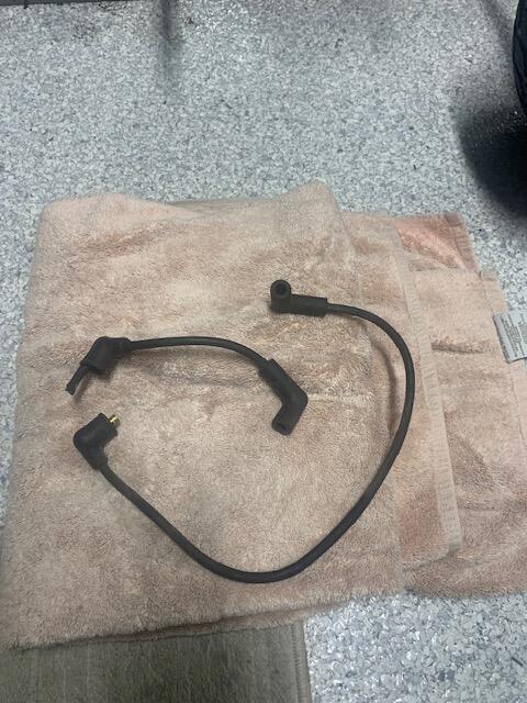

squonk 42,515 #2 Posted Saturday at 01:17 PM I can make them. What engine are they off of? Share this post Link to post Share on other sites

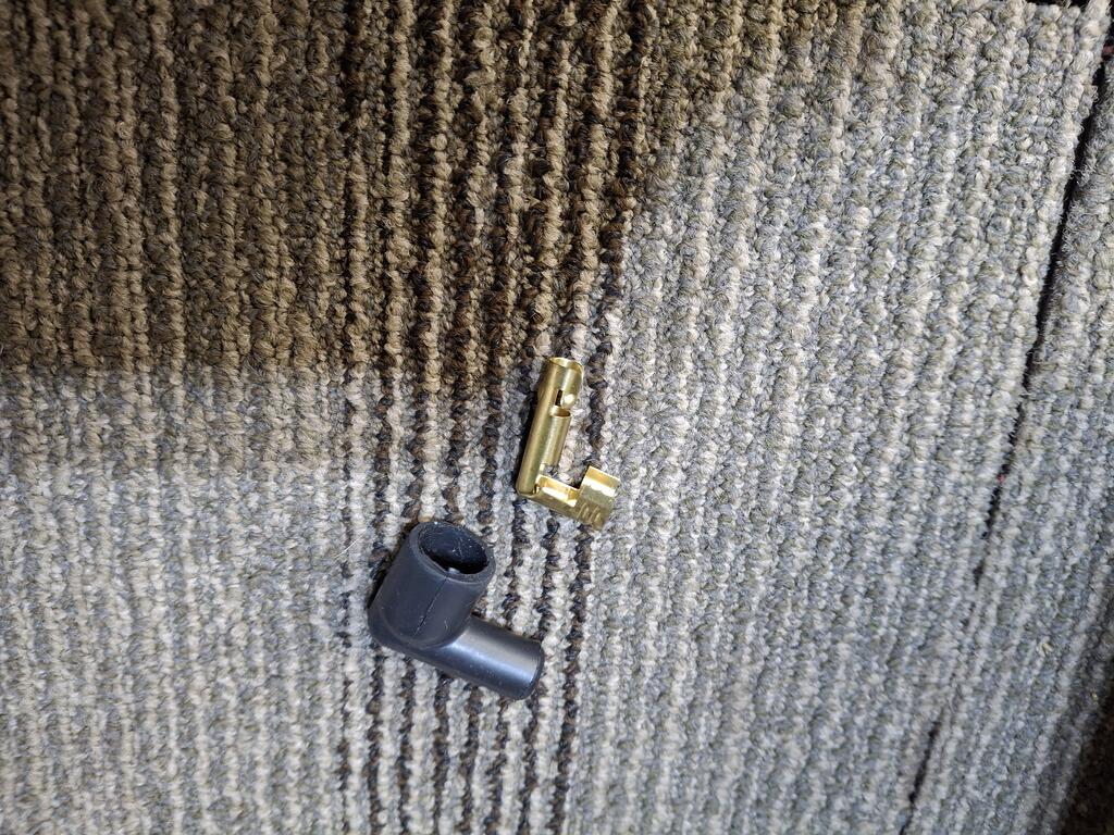

squonk 42,515 #6 Posted Saturday at 04:50 PM These are the correct coil terminal end and boot. I can make a set for $28 + shipping Share this post Link to post Share on other sites
Bill D 2,088 #7 Posted Saturday at 06:40 PM 1 hour ago, squonk said: These are the correct coil terminal end and boot. I can make a set for $28 + shipping Where do you get that terminal and what is the part number? Thanks. Share this post Link to post Share on other sites
squonk 42,515 #8 Posted Saturday at 06:44 PM (edited) @Bill D had to get a kit. Bought it from Summit Racing. Taylor is the brand. part # 46057 Edited Saturday at 08:21 PM by squonk Share this post Link to post Share on other sites
