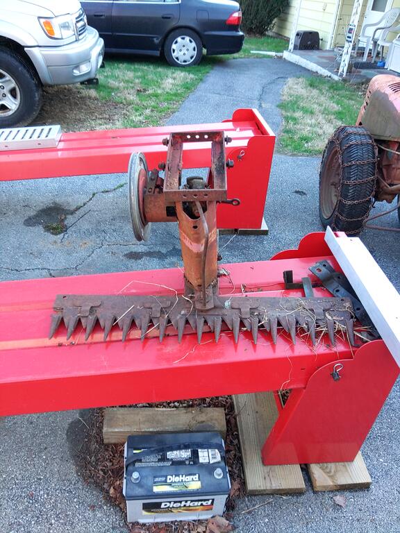

Anyone here adapt something like this to a Wheel Horse and how did you do it?  I'd consider doing it but I don't have a lot of time these days.
FYI, if anyone's interested in it please send me a PM.  It may be easier to send it down the road right now.
Update: I saw @Pullstart video.  Looks like you used parts from a snowblower to mount it??

Hey @Bill D, here’s my build thread on that project!
 A few things I would mention, in summary:
I used the Jari sickle and the DB wobble box for the extra width, to be outside of the Wheel Horse tire section.
I could easily cut any sapling tree that fit between the fingers.
I needed to slow it down even more than the jack shaft I created.
The wobble box had a counter balance.  I could have benefitted from doing more scientific experiments to see how moving it could have improved the balance of the longer blade.
I still have the scar from the 7/16” drill bit in my left hand.  :lol: Bumps and bruises thread here 🥴
