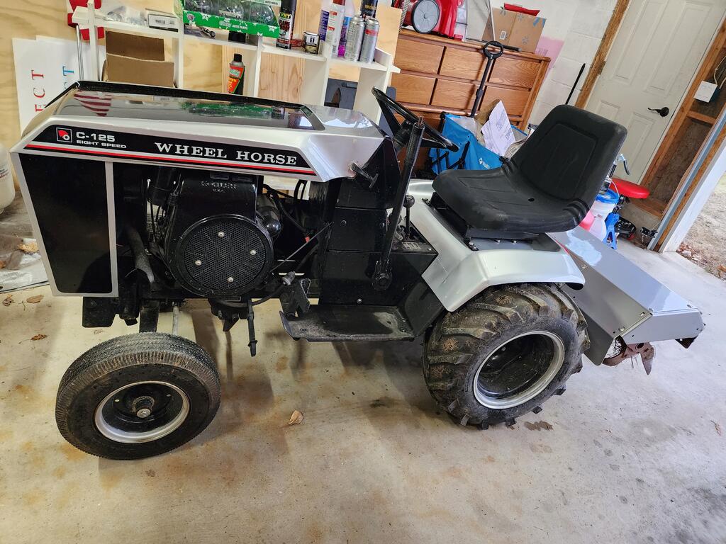

Skubi 1 #1 Posted Sunday at 03:34 PM Hello All! Bought my 1st Wheel Horse, and trying to verify belt sizes. It looks like the drive belt is 5/8 X 82", but is the rear tiller belt 1/2" X 139"? Thanks!! 1 Share this post Link to post Share on other sites

Skubi 1 #6 Posted Monday at 10:55 AM 9 hours ago, kpinnc said: Did you do the paint job? That looks fantastic! Reminds me of the NC Highway Patrol cars! Thanks, but the guy I bought it from painted it to match his truck while he had the engine rebuilt. Runs like a champ! Share this post Link to post Share on other sites
Dan 312-8 28 #7 Posted Monday at 12:02 PM Welcome to the addiction! Again, not any help on the belt, but that paint scheme is awesome. @c-series donthis is what I was describing to you how I would like to paint a 300 series tractor. 1 Share this post Link to post Share on other sites
kpinnc 13,665 #8 Posted Monday at 02:19 PM 3 hours ago, Skubi said: Thanks, but the guy I bought it from painted it to match his truck while he had the engine rebuilt. Runs like a champ! Well it looks like you got a nice machine. I hope it gives another 40 years of service! 1 Share this post Link to post Share on other sites
Skubi 1 #9 Posted Monday at 02:58 PM 37 minutes ago, kpinnc said: Well it looks like you got a nice machine. I hope it gives another 40 years of service! Thanks! I changed all the fluids, new spark plug, and new carb float, needle, and gaskets since it had sat for a while. Still a little hard to start, so running someseafoam through it before I adjust the carb. Share this post Link to post Share on other sites

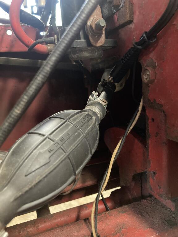

SylvanLakeWH 27,413 #10 Posted Monday at 03:00 PM (edited) 2 minutes ago, Skubi said: Still a little hard to start, Try a marine style fuel bulb... couple squeezes and mine fires right up... Edited Monday at 03:01 PM by SylvanLakeWH 1 Share this post Link to post Share on other sites
