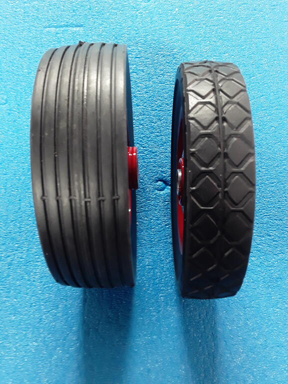

The ones on the above deck came from Tractor Supply.
  • Like 1
76c12091520h
  • Excellent 1
Handy Don
14 minutes ago, 76c12091520h said:
Definitely the wider wheels on the heavier 3-blade, belt driven decks that came from 1968 (or 1969?) onward for long wheelbase tractors. They would not be on an 856.
