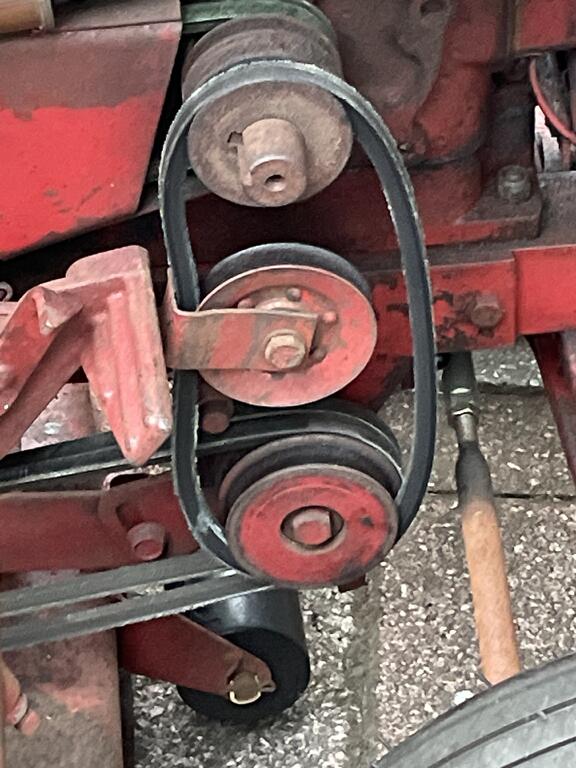

FLtractor 23 #1 Posted Friday at 12:53 AM Wondering how much a new one of these middle pulleys would cost to replace… i can hear the bearing so eventually it will need replacing. Unable to locate the part number in the online manual I’ve looked on here. Share this post Link to post Share on other sites
8ntruck 7,368 #2 Posted Friday at 01:19 AM Some folks have removed the rivets holding the halves of the pulley together, removed the bad bearing, replaced it and bolted the pulley back together. Wheel Horse used standard parts whenever they could. Makes them easier to keep going some 60 years later. Somebody will be along soon with more details. 2 Share this post Link to post Share on other sites
stvski80085 132 #3 Posted Friday at 02:00 AM (edited) It looks like an idler pulley to me. Don’t hold me to it though. Same as a lot of drive belt idlers. Edited Friday at 02:01 AM by stvski80085 1 Share this post Link to post Share on other sites
Blasterdad 3,025 #4 Posted Friday at 02:33 AM Part #71 IPL Pulley #1623 2 Share this post Link to post Share on other sites
Blasterdad 3,025 #5 Posted Friday at 02:38 AM https://wheelhorsepartsandmore.com/product/toro-wheel-horse-1623-1616-92-7102-pulley/ 1 1 Share this post Link to post Share on other sites
FLtractor 23 #6 Posted Friday at 04:48 AM 2 hours ago, Blasterdad said: https://wheelhorsepartsandmore.com/product/toro-wheel-horse-1623-1616-92-7102-pulley/ Does it make a difference with the one on my tractor having the rivets on outside compared to the one you sent me in the link? Same pulley? Share this post Link to post Share on other sites

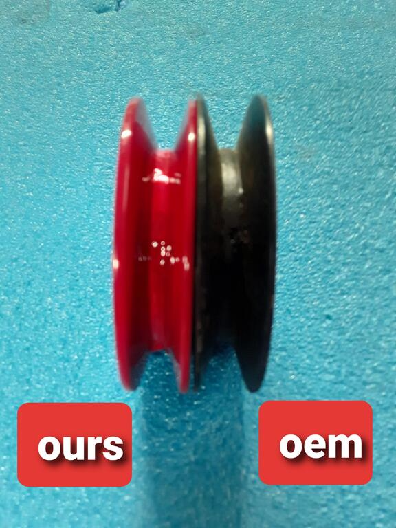

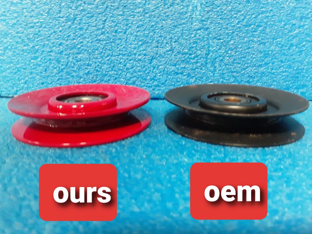

squonk 42,447 #7 Posted Friday at 11:13 AM I messaged Brian at K & B about reproducing these and this is what he came up with. @76c12091520h 1 1 1 Share this post Link to post Share on other sites
Blasterdad 3,025 #8 Posted Friday at 11:41 AM 6 hours ago, FLtractor said: Does it make a difference with the one on my tractor having the rivets on outside compared to the one you sent me in the link? Same pulley? Shouldn't make any difference. I like the looks of K & B's pulley, looks like a better quality, both should work fine though. 1 Share this post Link to post Share on other sites
peter lena 9,074 #9 Posted Friday at 12:28 PM @FLtractor if you use the original type , looks like you have the wide rubber side grease shields , OPORTUNITY IS THE WORD , very small flat putty knife or flat pocket screwdriver , carefully remove side shields , wipe out original " lubricant " carb cleaner flush out go lucas green hd chassis grease . polyurea rated , 550 flash point , change that into a smooth / quiet set up , only a suggestion , pete 1 Share this post Link to post Share on other sites
