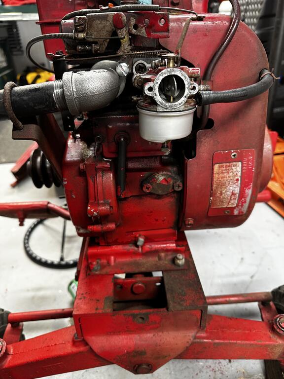

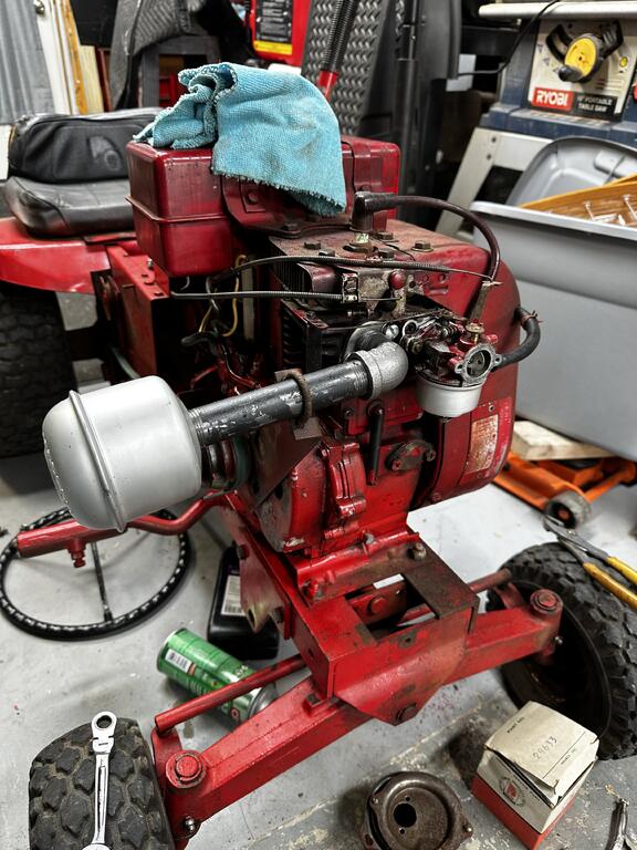

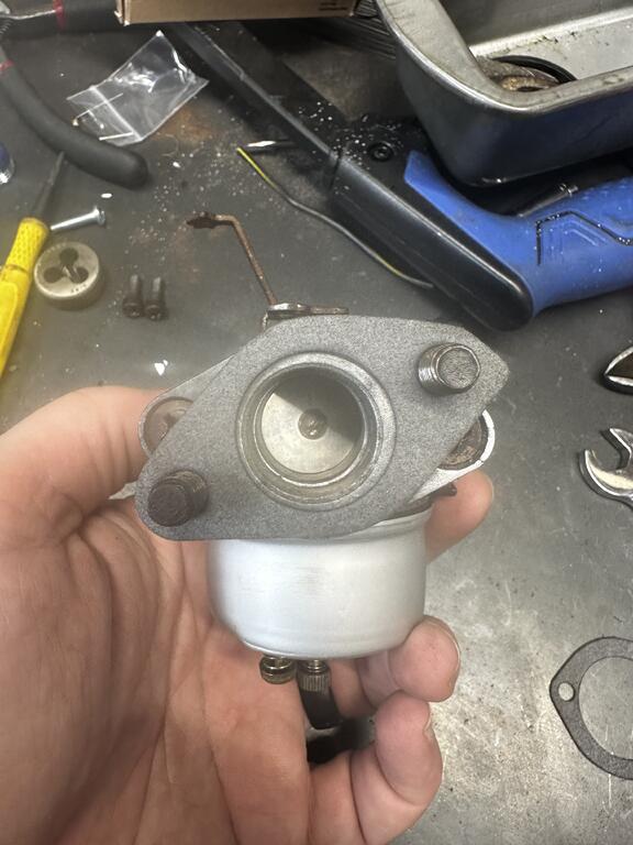

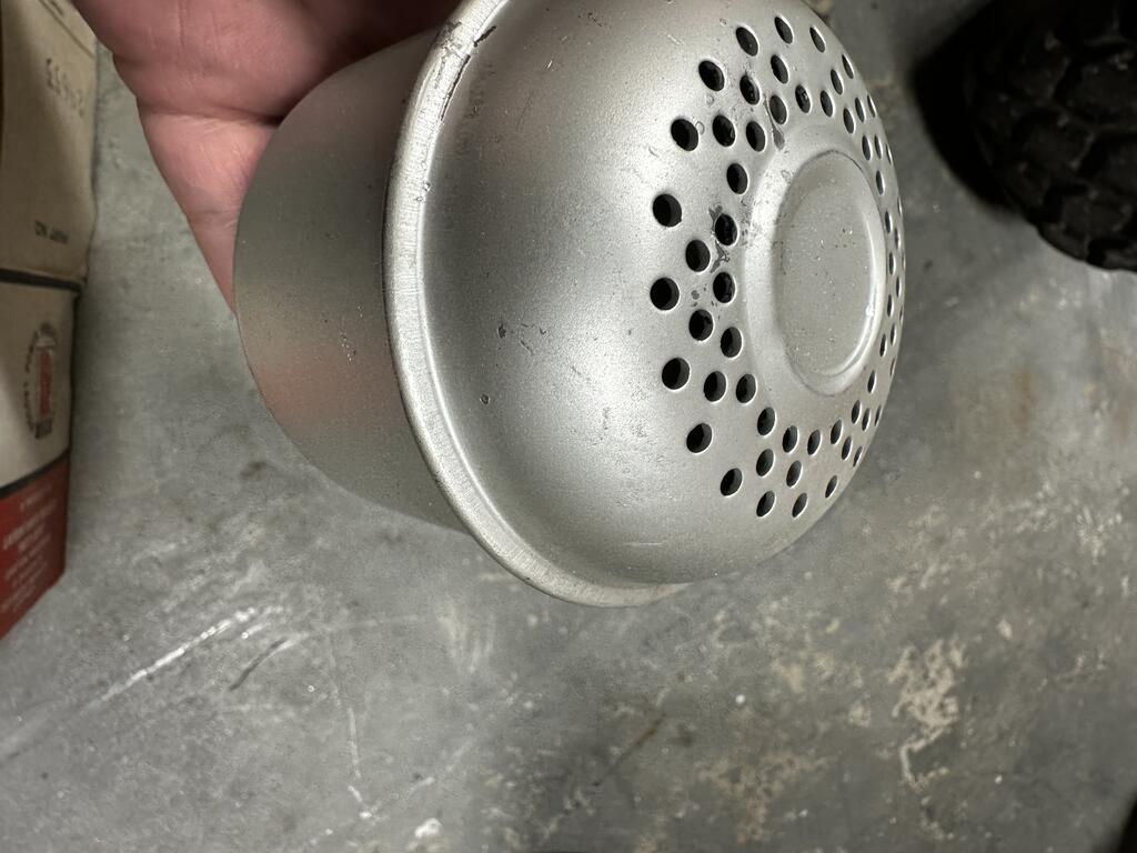

I have always wanted a Lawn Ranger and thanks to Handy Don and Pullstart I now have a Lawn Ranger.  I think this will eventually get a full restoration, but in the mean time changing the muffler out to the spin on type to get the exhaust out from under the hood.  Changing the oil and transmission oil. Cleaning an d rebuilding the carb. Installing new used tie rod ends (you just gotta love going down a hill and the tie rod ends pop off) new fuel line and filter, and install a battery and new wiring. This little tractor has been well taken care of over the years,  she just needs to be cleaned up and loved on and then put to work.

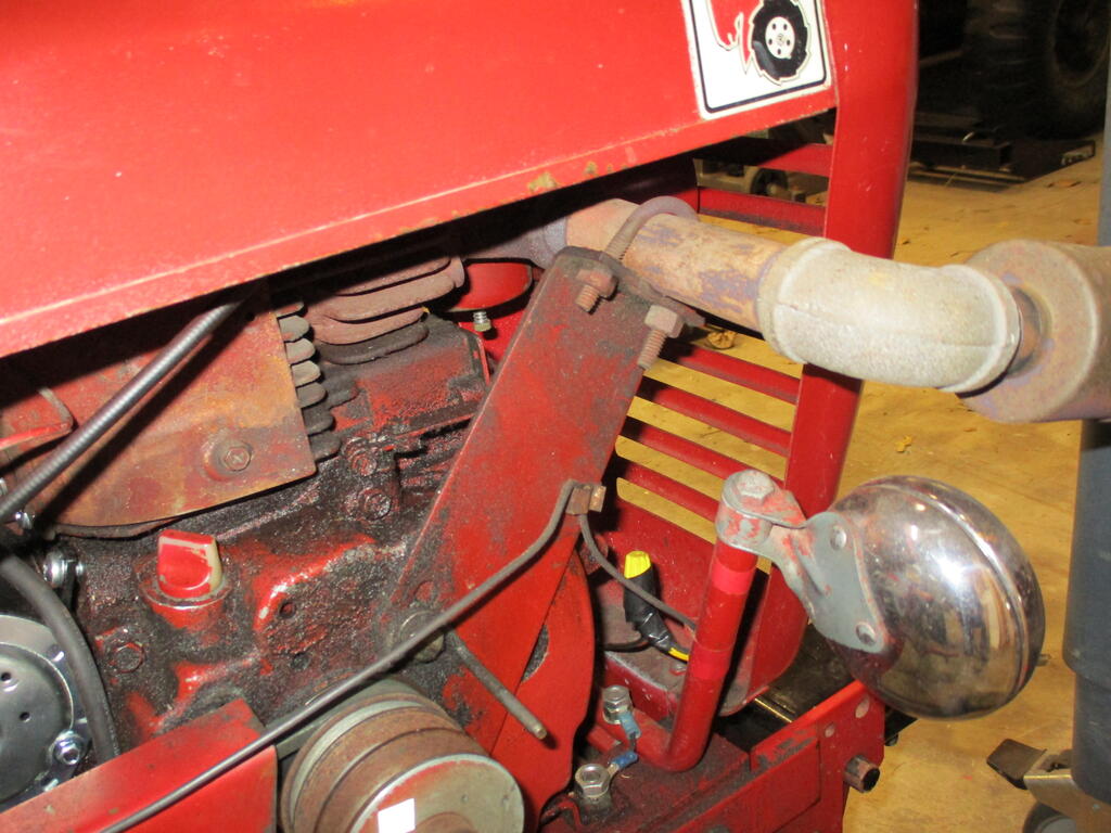

If that Tecchy gives any trouble, a K181 Kohler will fit nicely. IMG_20240302_153936617.jpg.9b1d5cac8e03ae591d03e0cc66b5b7eb.jpg

  • Like 4

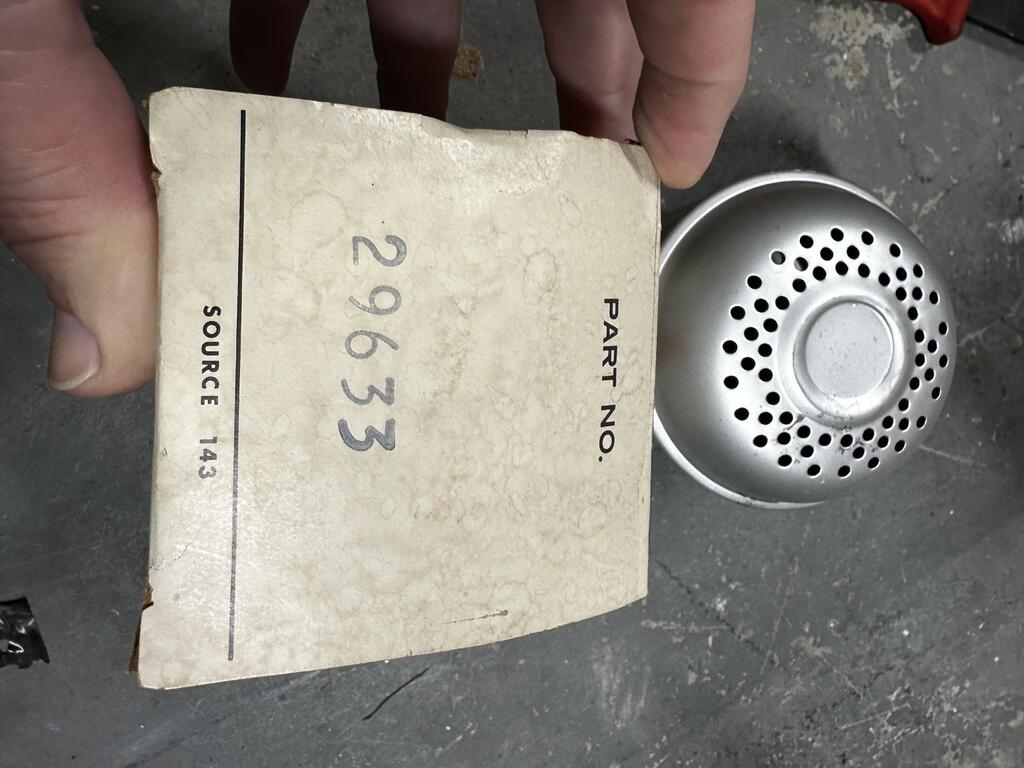

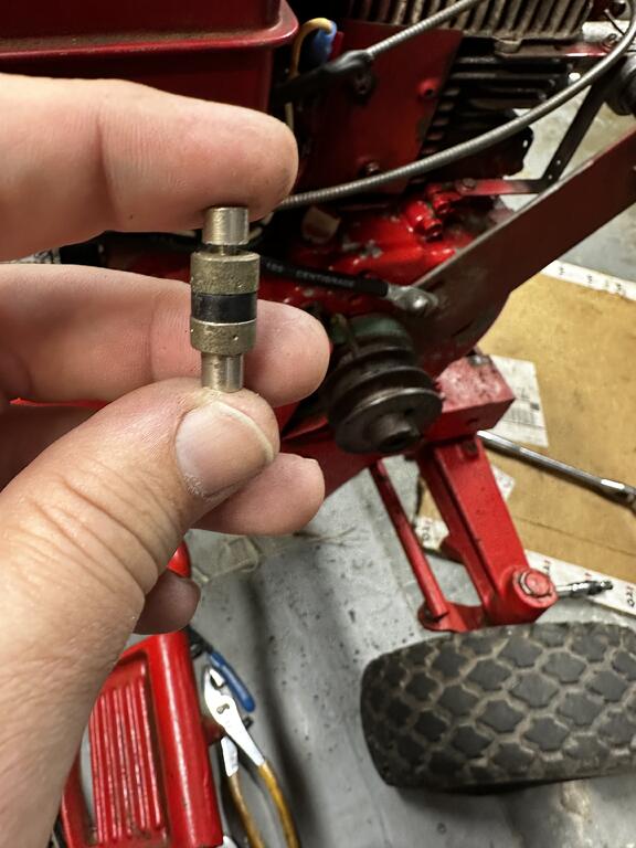

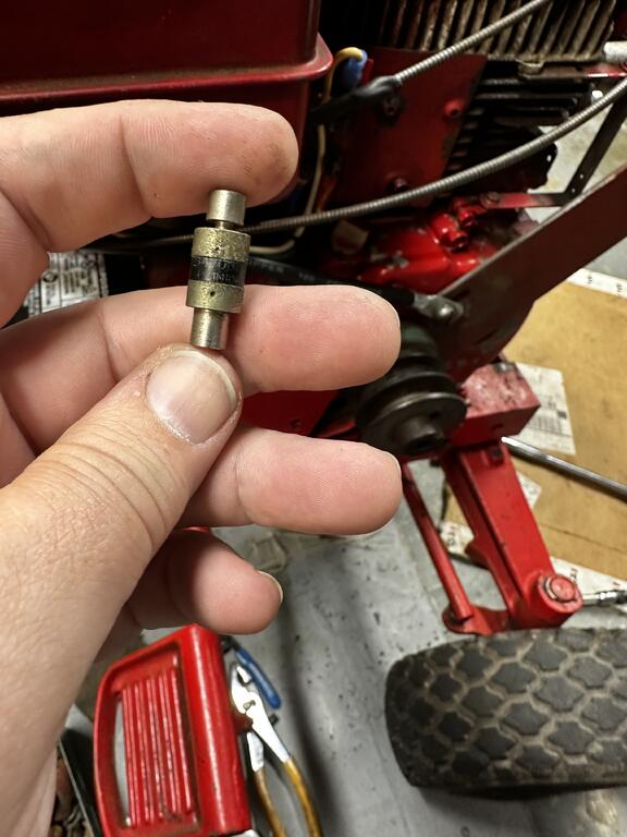

I like that bolt on thread adapter for the muffler. Something you made?
Handy Don
That’s a standard Tecumseh part for many of the smaller engines.
  • Thanks 1
p38js
It is made by Tecumseh @Handy Don told me about it when I when I got the tractor from him.  It took me awhile to find it, and once found one, like three more all of a sudden appeared

@kpinnc as much as I like the Kohlers I’m going to try and keep the little tecky going.  If I remember correctly from @Handy Don the original engine has already been swapped out I believe it should have a H60 and this is a HH60, I’m not 100% sure what the differences are but for starters the exhaust needs the bolt on adapter.  So I’m sure there are more surprises to come in trying to find parts

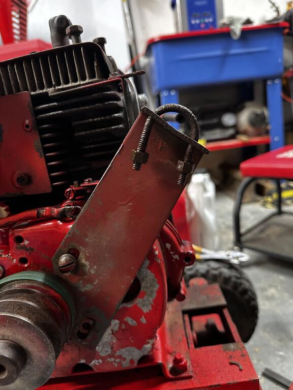

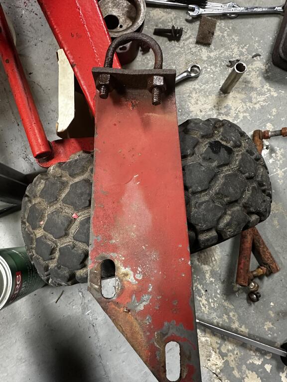

p38js
Another piece of the puzzle showed up yesterday, the exhaust bracket.

ebinmaine
Where can I find one of those?
pfrederi
I like to have the exhaust down and to the front not blowing back in my face
p38js
@pfrederi that is a good idea, is that muffler quieter than this one.  When I’m at the show my tractors all sound like I’m running cherry bombs and all the other tractors are nice and quiet.  Maybe it’s just my imagination
pfrederi
Maybe quieter because it sends the noise out front.
