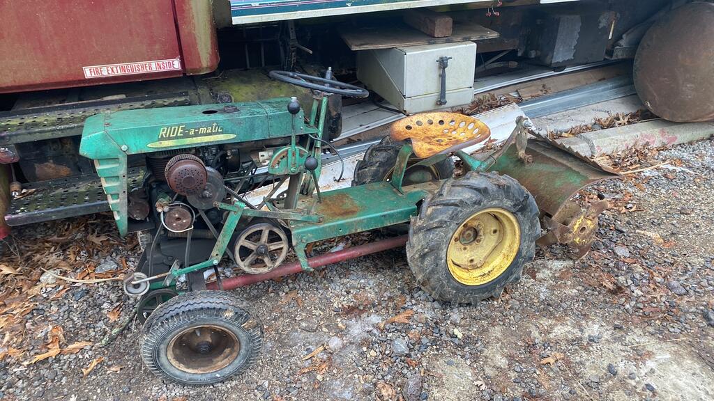

1959 Bolens ride a matic
Donavon1
Rebuilding the rototiller what grease would you guys recommend

Donavon1
The rototiller was full of grease was wondering what was the best to use for the rototiller
