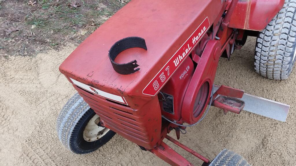

Dose anybody know we're I can get a 1967 wheelhouse 6 speed rear brake belt replacement for reasonable price  under $100 hopefully  mine is trashed dry rotted badly just feel apart tractor was sitting for long time belt could hold up dont the ton of money to spend make sure shipping included on price

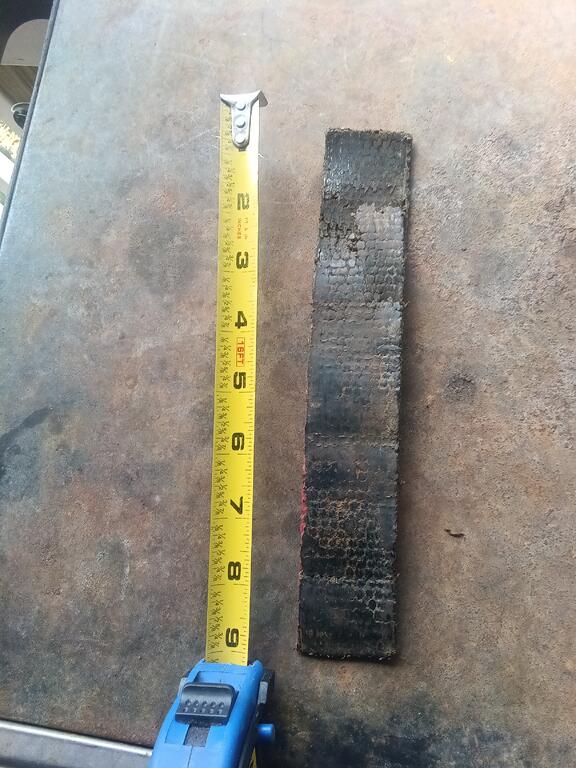

Only 1 1/2 wide
And around 9 to 9 1/2 long
It broke so can be positive on how long
And 3/16 thick
Only 1 1/2 wide
And 3/16 thick
I have them ready to go. Contact me by personal message or text (443-398-6544) and I will give you a special price. Discounted 10%, tax-free, and shipped tomorrow.

:text-welcomeconfetti:to the:rs: BTW, we refer to that as brake lining.    It gets glued to the brake band.  Bob will furnish instructions with the new lining.

When changing the lining, be sure the drum is clean of any grease or rust, too, to prevent contaminating the new lining.
And a friendly warning about Bob’s brake linings: if you are used to weak braking you’ll be shocked at the improvement.
