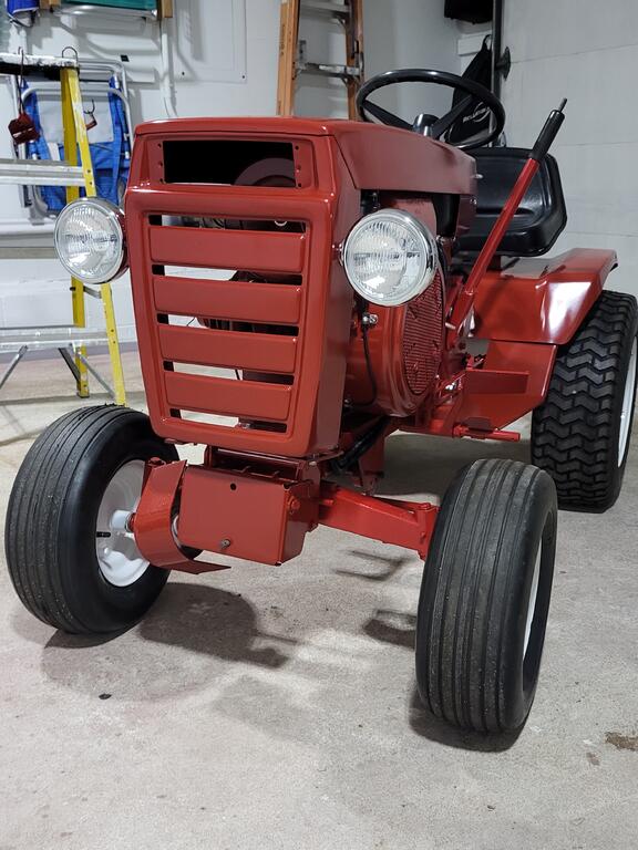

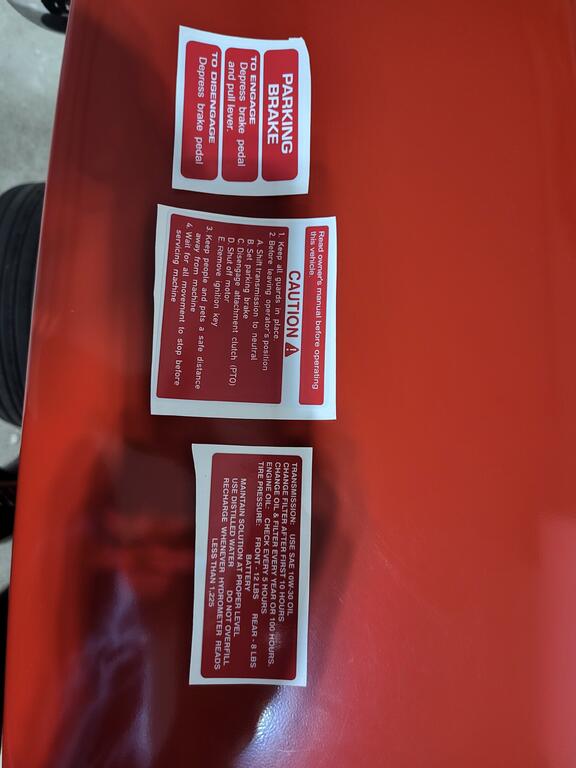

if someone would be so kind in assisting me with the correct location for these last few decals on my C-120.  Second resto ive done, second time ordering from redoyourwheelhorse.com which i highly recommended. A absolute pleasure doing business with. Im gonna post a write up detailing the full restoration soon, im in the process of finishing the mower deck than i will. I am having slight trouble locating a decent used light or emblem escutcheon for the hood. If any member has something they want to part with for a reasonable price, hit me up!

Well... hopefully it's for an automatic..since the one decal lists the wrong oil for an 8 speed
matt monte
its not,i noticed that as well,lol nothing about it is stock anymore so.....just dropped $100 on a used light, oh well.

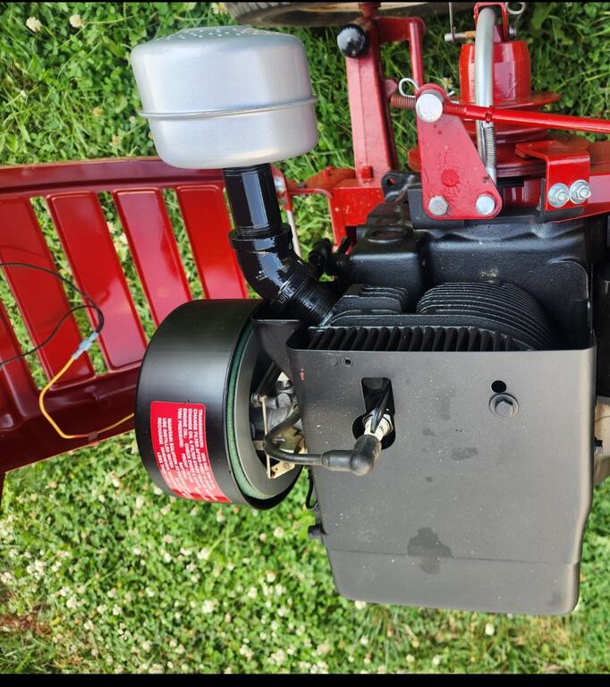

Mine is an 8speed also but I have a magnum engine and placed mine on the air cleaner..i did ask Terry for a replacement decal

no clue on the year.  C-100 main body was rusted to badly to use, ill have to search if i took a pic of tag. It doesn't matter. Its a mix between 3: C-125,B80 & C-100. They sat uncovered, untouched for 22yrs.Some parts were rusted beyond repair The mower deck was in garage thank god. They were headed to scrapper before i saved them to make one. Waiting on a hood light and some misc smalls from A-Z, then ill post pics and if there is any interest, ill take the time to post pics of complete restoration, Took 2yrs in between other car and house projects.  Thx for pics, i would of put brake sticker on the side that has the brake pedal, thought that would make sense. That one goes up on right side of hood? Ehh, not sure im gonna install that, ill have to think about it.

love it bro. its like shoving a 5.3/6.0  LS engine into a older hot rod, all the rage nowadays. Ive been thinking about it myself. Definitely will mount the brake decal on the pan but most likely will put the other 2 on the under side of hood. what is that front wheel set up u got?  looks cool. Waiting on: Blades, belts, hood light. Once i get everything mounted up Ill share with forum. My wife says she doubts ill use it to mow but I do plan on it,lol Although there isnt a speck of dirt on her......idk...😂
