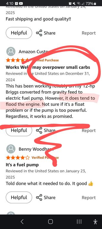

Ok, I found the mechanical fuel pump was not working.  I took it apart and the diaphragm looked good. I decided to go with an electric fuel pump, and got the the cheap chineseium pump that was discussed earlier and or elsewhere.
https://a.co/d/dRdu7SM
I mounted it directly below the carb, where the mechanical fuel pump was, modified to fit the bolts from the old fuel pump, and atop a blockoff plate I made.
The engine started right up, but then gas started pouring out of the carb. Since I had removed the needle clip earlier, I put that back, and I confirmed that with the float down I could blow through the intake. With the float up, nothing would flow.
I'm not sure why this is occurring; is it possible that mounting the fuel pump so close to the carb could have any impact? Should it be mounted back by the fuel tank? It is obviously overpowering the needle valve.
This isn't my first carburetor rodeo, so I'm a little confused.
Edited by HyperPete
ebinmaine
Might be too powerful or have a poorly regulated regulation regulator.
2009923510_Screenshot_20250411_161019_Chrome2.jpg.69523609493d8e50cb6eca980c316f4d.jpg
  • Thanks 1
HyperPete
Shoot!
The threads I read said 3# is a good target pressure. This is supposed to be 2.5 to 4.
Is there such a thing as a passive fuel pressure regulator, such as a small restrictive fitting?
I hate to keep throwing money at this thing without a rototiller.  If I can't find one, it's pretty much useless to me. 🥺
I could always put it on the 1-0440, but I believe that if it ain't broke, don't fix it!
