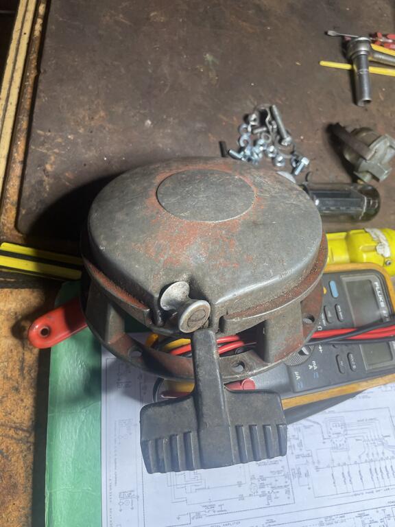

Maynardb 13 #1 Posted March 19 I have this recoil starter that I’m not sure what it came off of but does anyone recognize it? It says on it, that it’s made by Fairbanks Morse. thx 1 Share this post Link to post Share on other sites
Pullstart 64,467 #2 Posted March 19 I don’t know, but that roller raises more questions to me than answers! Share this post Link to post Share on other sites
wallfish 17,484 #3 Posted March 19 (edited) I'm going with Fairbanks for a Clinton https://www.ebay.com/itm/126705407774?chn=ps&norover=1&mkevt=1&mkrid=711-213727-13078-0&mkcid=2&itemid=126705407774&targetid=4581046493380275&device=c&mktype=&googleloc=&poi=&campaignid=603247657&mkgroupid=1239150647972013&rlsatarget=pla-4581046493380275&abcId=9316139&merchantid=51291&msclkid=cece93aacc161f296f0af471e0ff0cfb Edited March 19 by wallfish 1 Share this post Link to post Share on other sites

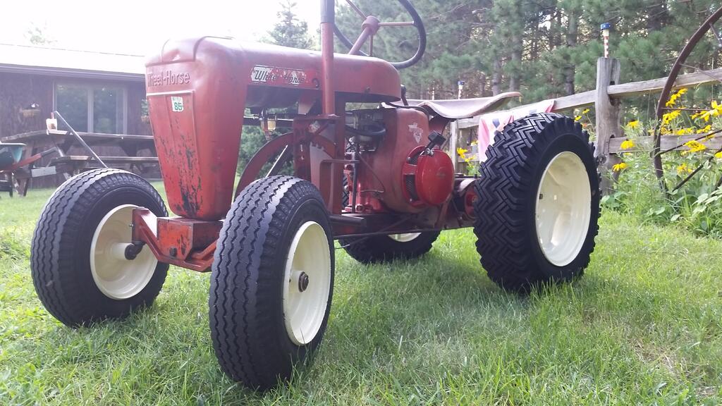

WHX?? 50,691 #4 Posted March 20 (edited) Indeed a fairbanks. Kohlers had them too. The 633 @Achto is doing now has one. 'Fish is also correct. Your 401 with the Clinton has one Kev. Unless you are using it to move chicken coops around ... The roller and all. Handy guide to common recoils. Engine Clinton Recoil starter ID.pdf Edited March 20 by WHX?? 3 Share this post Link to post Share on other sites
squonk 42,505 #5 Posted March 20 (edited) 10 minutes ago, WHX?? said: Indeed a fairbanks. Kohlers had them too. The 633 @Achto is doing now has one. 'Fish is also correct. Your 401 with the Clinton has one Kev. Unless you are using it to move chicken coops around ... The roller and all. Handy guide to common recoils. Engine Clinton Recoil starter ID.pdf 4.77 MB · 0 downloads Kevin is moving that bus with a 401? Edited March 20 by squonk 1 3 Share this post Link to post Share on other sites
WHX?? 50,691 #6 Posted March 20 (edited) 23 minutes ago, WHX?? said: Your 401 with the Clinton has one Kev. I take that back my bad Kev you don't have one ... I put it on a 400 that has a Clinton. Edited March 20 by WHX?? 1 1 Share this post Link to post Share on other sites
953 nut 57,839 #7 Posted March 20 14 hours ago, Pullstart said: roller raises more questions That roller lets you pull the starter from the side rather than being in line with the engine. We had a grain auger you would have had to straddle to start up if not for the roller. 4 Share this post Link to post Share on other sites
